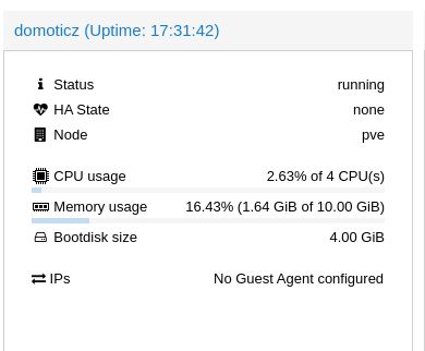

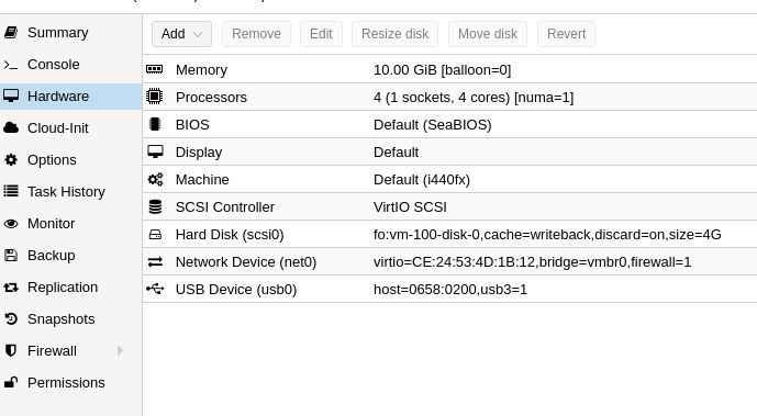

Please help me.
I’ve been struggling with this for days and I don’t understand why there’s no improvement.
I used RPI3 B + before. There mysql/mariadb version did not work ,the basic version only worked.
But I have not achieved the good times as you have achieved.
I switched systems now.
My current system is an Asrock Q1900DC-ITX motherboard ( j1900 CPU 4 core, 2 GHz), 2 x8 GB Dual Channel 1333 MHz, DDR3L ram. 1pc sata3 30 GB SSD. A Crucial mx500 250 GB SSD (sata) will arrive tomorrow.
I use now a Proxmox system, there is 1 Virtual Machine only in the system. The storage space of the VM (no swap) is 4 GB, the size of the allocated ram is 10 GB.
What were in the description were things I installed.
Debian 10 Buster minimal system
Domoticz
Apache 2
PHP 7.3
Mariadb 10.3.23
In Domoticz, I turned off Dzvents. I deleted all Dzvent rules. In the / home/user/domoticz/scripts/lua folder, only the there is a script_device_pass2php.lua file.
Contents:
What I'm trying to do is turn on the electricity as fast as possible when there's movement.
My php file looks like this:
The problem is that even with the slow RPI 3B + device I achieved close to these values: .
Now with Proxmox:
549 -> 701 = 152 ms ( it's even "much" slower than the zwave association.)
my top (VM):
How can i find out what the bottleneck is, what is misconfigured?
Proxmox configuration
I want to achieve a total response time of 15-30 ms
Thanks.
