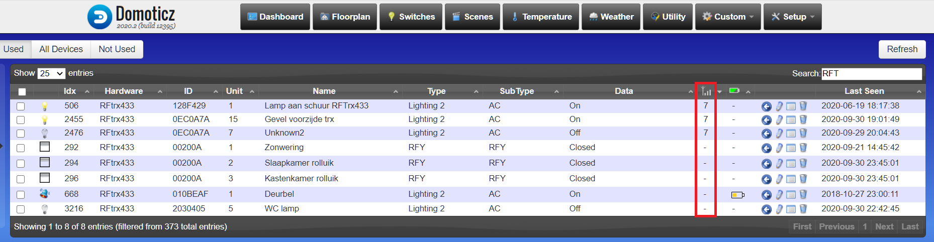

Ok. In this case I think none of my sensors can transmit RSSI. I can´t see any value on any device in the GUI and when I use the script, I didn´t get something in the log.
Re: Show RSSI-Level of all devices
groovesurfer wrote: Thursday 01 October 2020 22:34 Ok. In this case I think none of my sensors can transmit RSSI. I can´t see any value on any device in the GUI and when I use the script, I didn´t get something in the log.
Could well be.
The only devices from my system displaying a signal level are with RFXCOM - RFXtrx433 USB 433.92MHz or Evohome via WEB API hardware types.
