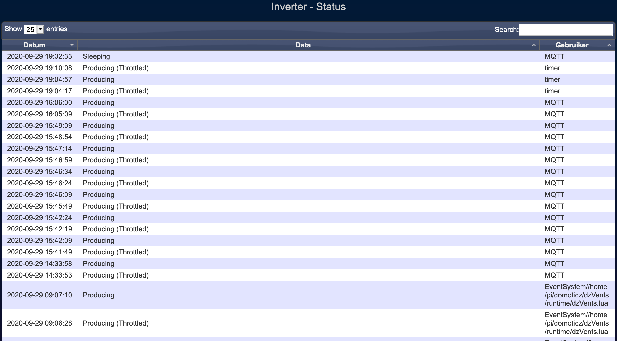

Running for 2 days now and I am very pleased with this plugin.
I notice something in I can not explain ...
Screenshot 2020-09-30 at 07.13.34.png (363.96 KiB) Viewed 21826 times
Why do these events occur with different users ?
Why are some events caused by "timer" ???
RPI4 Beta / Tasmota / ZigBee2MQTT / P1meter / Haier AC MQTTmapper / SolarEdge SE3500H modbus_tcp / IndeVolt SF3000 / Opentherm gateway / Plugwise Anna/Smile / ObserverIP weatherstation thru WuDirect

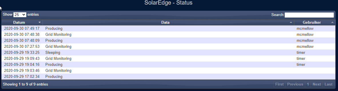

Having the same as Eddieb.
The plugin is running 24/7 During sleeping hours, 'sleeping' data is still added to the database. Can we change this?
Greetings McMelloW

McMelloW
Posts: 435
Joined: Monday 20 November 2017 17:01
Domoticz version: V2024.1
Location: Harderwijk, NL
Re: New Python plugin: Domoticz SolarEdge_ModbusTCP
Post by McMelloW »
I don't know about the different users either.
What I understand from my supplier. The inverter goes to the status sleeping when the production is less the a certain amount on the panels.
Up till now, I have used a DzVents script with a perl script to readout the inverter. This is active only during daytime.
		timer = { 'every minute between 15 minutes before sunrise and 15 minutes after sunset' }
The inverter is allways in sleeping status during this time interval.
Greetings McMelloW

Posts: 431
Joined: Wednesday 04 July 2018 7:48
Post by eddieb »
at least the Temperature, P1 Voltage and Frequency counters work 24/7.
the inverter self does not update the other counters when idle ...

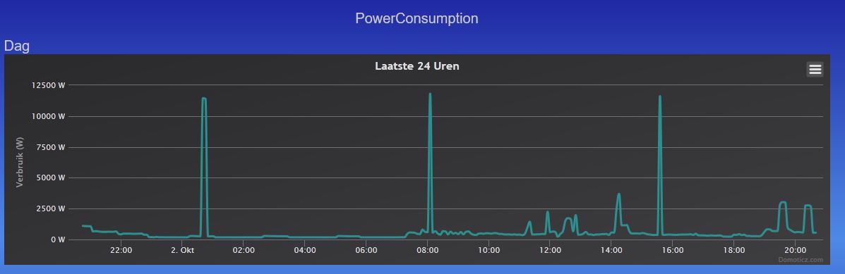

I am running a script here that counts P1power and Solarpower into Realpower.
The script is triggerd by Solarpower and is pretty accurate.
Except when there is fast fluctuation in Solarpower ... The values from the inverter seems to have a small delay compared with P1 ...
My calculation sometimes give me NEGATIVE Realpower usages because of this !

eddieb wrote: Wednesday 30 September 2020 7:16 Running for 2 days now and I am very pleased with this plugin.
To be honest: I have no idea...
I have not added anything in the plugin to work with users, so this must be one of the nice hidden features of Domoticz.
If time permits, I will try to replicate it on my setup and investigate.
