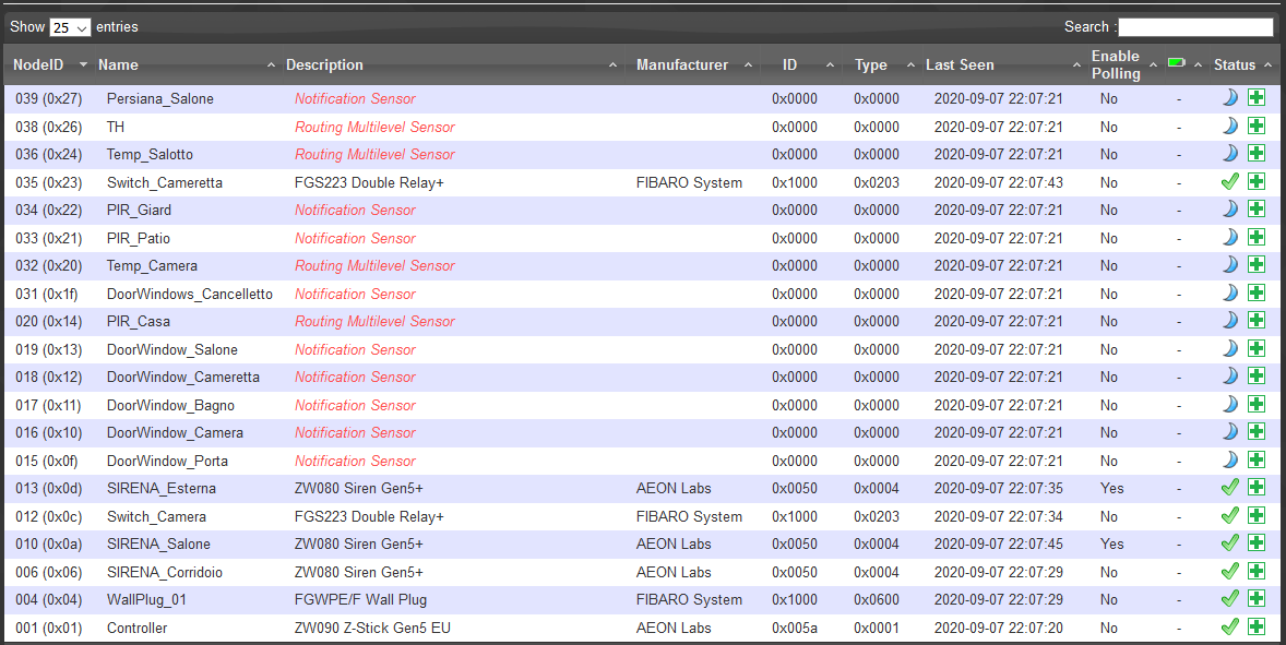

after the upgrade to the lastest beta some nodes description manufacturer, id and type not shown anymore and not working.
See image
Zwave node not identified after latest beta update

all battery powered devices?
Include them again
Include them again

Hi !
Same problem for me with qubino nodes since i've updated from an old version.
I can control (on/off/dim) node's devices but i can't access to node configuration.
If i plug me zwave controler on a computer running 4.10717 version of dz i've no problem.
I've try to reset modules and add them again: same problem
Someone have an idea ?
