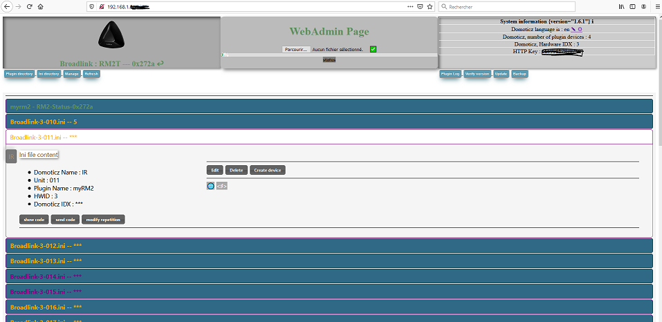

For me the interface looks different.
zak45
Posts: 954
Domoticz version: V2024.4
Re: Python Plugin : Broadlink
Post by zak45 »
yo3ggx wrote: Saturday 19 September 2020 9:17 For me the interface looks different.
what you see is the GUI for device management.
Once you have learned/saved an IR / RF command, this wil create an ini file.
This ini file will be seen there, and by clicking on it, you should see corresponding GUI.

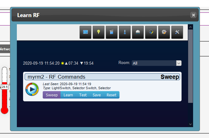

This is what I said, I cannot learn/save a RF command. When I click on Sweep and then press a button on the RF X10 remote, the Learn button is activated. Pressing on it do nothing, same if pressing on Save. What's the right procedure to learn RF devices? For IR devices seems to work.

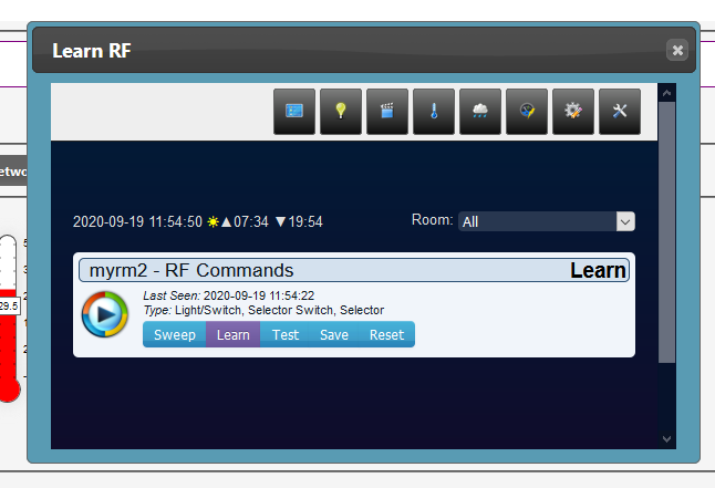

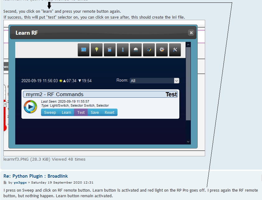

yo3ggx wrote: Saturday 19 September 2020 11:45 What's the right procedure to learn RF devices? For IR devices seems to work.
Near the Broadlink device :
First, you need to click on sweep and let your remote button pressed until Broadlink led light off.
If success, this will put "learn" selector on.
Second, you click on "learn" and press your remote button again.
if success, this will put "test" selector on, you can click on save after, this should create the ini file.

I press on Sweep and click on RF remote button. Learn button is activated and red light on the RP Pro goes off. I press again the RF remote button, but nothing happen. Learn button remain activated.

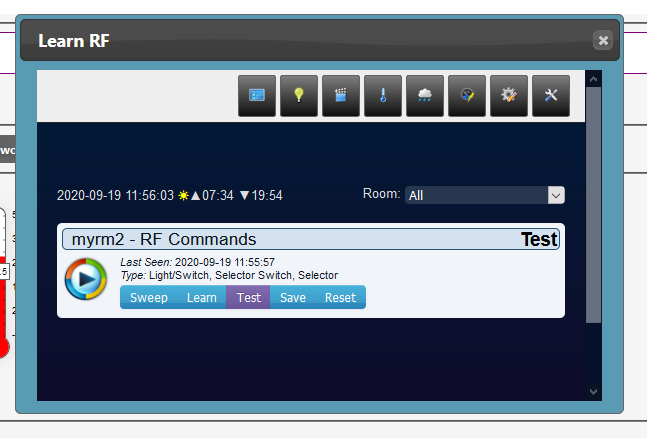

If I click on LEARN after is already activated from the previous step, LEARN goes off. If I press again on it, nothing happen when I press the button on the remote.
No mater what I try, Test button cannot be activated, same for Save.

yo3ggx wrote: Monday 21 September 2020 12:19 If I click on LEARN after is already activated from the previous step, LEARN goes off. If I press again on it, nothing happen when I press the button on the remote.
if nothing happen, Broadlink device do not focus on the right frequency. In this case, restart full process: Sweep ... Learn etc..

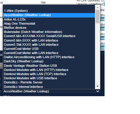

hello friends
Can you tell me where the error may be. I installed plugin setup.py.
I installed the plugin with positive results
I did a domoticz restart
Unfortunately, I do not see it in domoticz
Bez tytułu.png (23.61 KiB) Viewed 2458 times

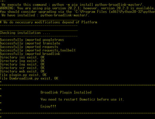

When i have installed the pluging i have an error message :
"Checking installation ....
Successfully imported googletrans
Error importing translate
The rest of installation is correct. In integration of domoticz i have this message...
2020-10-08 15:42:19.545 Error: (Broadlink) failed to load 'plugin.py', Python Path used was '/home/pi/domoticz/plugins/Broadlink/:/usr/lib/python37.zip:/usr/lib/python3.7:/usr/lib/python3.7/lib-dynload:/usr/local/lib/python3.7/dist-packages:/usr/lib/python3/dist-packages:/usr/lib/python3.7/dist-packages'.
2020-10-08 15:42:19.545 Error: (RM4-SAM) Module Import failed, exception: 'ModuleNotFoundError'
2020-10-08 15:42:19.545 Error: (RM4-SAM) Module Import failed: ' Name: broadlink'
2020-10-08 15:42:19.545 Error: (RM4-SAM) Error Line details not available.
2020-10-08 15:43:31.177 Error: RM4-SAM hardware (2) thread seems to have ended unexpectedly
The file 'plugin.py' exist in the directory /home/pi/domoticz/plugins/Broadlink/
pi@raspberrypi:~ $ python --version
Python 3.5.4
Some help ?
Thank you

skywi13 wrote: Thursday 08 October 2020 17:02 "Checking installation ....
Python 3.5.4
Be sure to have executed installation with sudo ... and that rigth python version has been set for your system not only for your user ...
Modulenotfounderror has been already discussed many time, check on this topic.

Double check that your python soft. has been setup with the right settings.. see wiki (executed with admin mode, all users & include in path if I remember well)

Post by matekogon »
Zak45
everything is already working. I installed in the wrong folder. I still have a question.
