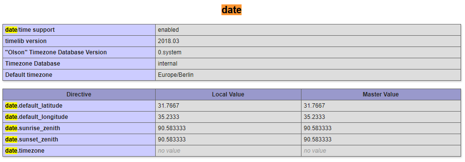

Egregius wrote: Wednesday 01 July 2020 10:27 Do you have your timezone set in your php.ini?
in /etc/php/7.3/fpm
[Date]
; Defines the default timezone used by the date functions
; http://php.net/date.timezone
date.timezone = 'Europe/Brussels'
I've changed this but for some reason it doesn't change.
when I check my php config I still see the default:
2020-07-01 10_42_07-PHP 7.3.14-1~deb10u1 - phpinfo().png (13.43 KiB) Viewed 3048 times
2020-07-01 10_41_39-PHP 7.3.14-1~deb10u1 - phpinfo().png (16.79 KiB) Viewed 3048 times
am I doing something wrong?

did you restart the php fpm service to load the new ini?
service php7.3-fpm restart
Trigun
Posts: 390
Domoticz version: 4.10717
Re: Pass2PHP
Post by Trigun »
Really?? I restarted NGINX but that didn't do the trick haha :D
thanks, this works!
hopefully the time script will work better now.
Keep you posted
