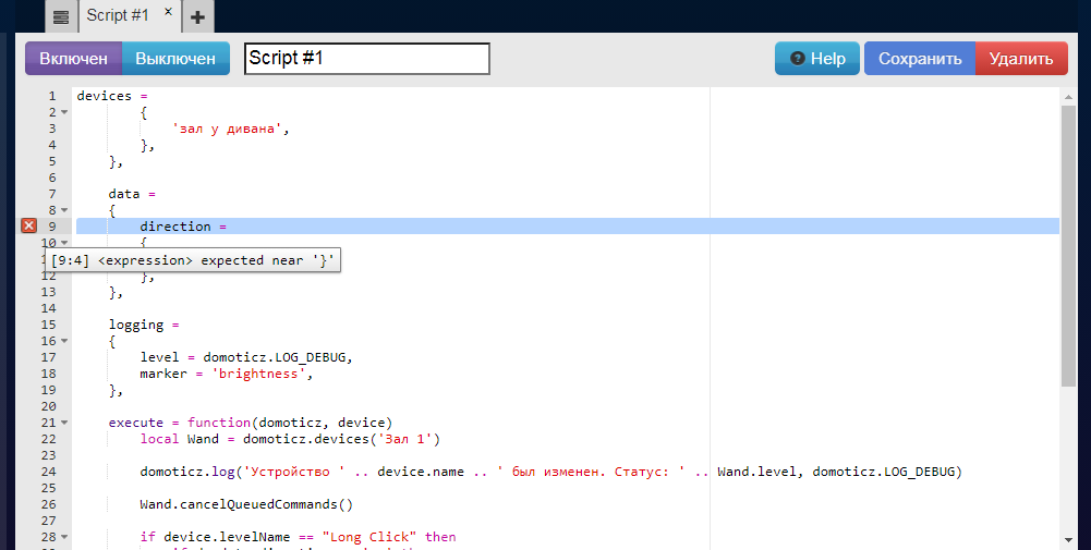

diman27
Posts: 6
Joined: Sunday 30 August 2020 16:12
Location: Russian
Re: Change the brightness with a button (long hold)
Post by diman27 »
Error, not working.
boum
Posts: 136
Joined: Friday 18 January 2019 11:31
Domoticz version: 4.10717
Location: France
Post by boum »
Please, check what you are copying in the script editor. You are missing the first 4 lines of the script. No wonder there is an error.
diman27 wrote: Wednesday 16 September 2020 1:39 Error, not working.
