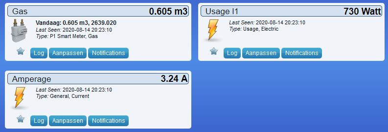

After that some adjustments are needed in the settings / hardware which you can see in the attached image.
Beginners mistake only one is actualy needed as all virtual switches can be generted on one.
The virtual switches need the correct name as mentioned in the script:
  • Power - type [P1 smart Meter (Electric)]
  • Gas - type P1 [smart Meter (Electric)]
  • Usage l1 - type [Usage Electric]
  • Voltage - type [voltage device]
  • Amperage - type [amperage device (1 phase)]
Again many thanks to Waaren for the help and patient to get this working !!
Rgds P.
Ps I added a small example image on how it will look like.

urool
Posts: 8
Joined: Thursday 03 September 2020 22:22
Re: Domoticz + P1 monitor share device
Post by urool »
Thanks for your quick response I now see the three following messages:
Method updateP1 is not available for device "Power" (deviceType=General, deviceSubType=kWh). If you believe this is not correct, please report.
An error occurred when calling event handler p1-file
/domoticz/scripts/dzVents/scripts/p1-file.lua:93: attempt to call a nil value (field 'updateEnergy')
urool wrote: Thursday 03 September 2020 23:15 Thanks for your quick response I now see the three following messages:
You used an incorrect type for the "Power" device. It must be defined as: P1 smart Meter (Electric)
Please also look in the script as what types the other devices must be defined.
The error message should not be the only logline from this script. Please share the rest of the log
urool

Thanks now the log window shows no errors anymore. The counters Voltage and Amperage stay at zero and the counters for Power and Usage l1 only show values for phase L1.
2020-09-03 23:51:30.377 Status: dzVents: Info: Handling Domoticz custom event for: "readTelegram"
2020-09-03 23:51:30.377 Status: dzVents: Info: readTelegram: ------ Start external script: p1-file.lua: Custom event: "readTelegram"
2020-09-03 23:51:30.395 Status: dzVents: Debug: readTelegram: Processing device-adapter for Power: P1 smart meter energy device adapter
2020-09-03 23:51:30.396 Status: dzVents: Debug: readTelegram: Processing device-adapter for Gas: Gas device adapter
2020-09-03 23:51:30.397 Status: dzVents: Debug: readTelegram: Processing device-adapter for Usage l1: Electric usage device adapter

Post by urool »
The script is working thanks for that, but now I need to find out how to get the voltage from another source and put that source in the script.
urool
Posts: 8
Post by urool »
Hi, I now have a device in Domoticz that shows the Input Voltage, the device name is "Input Voltage", how can I use the device "Input Voltage" to let the script to calculate the the amperage. I know how to calculate the amperage by devide the Power/volt.
urool wrote: Monday 07 September 2020 23:52 Hi, I now have a device in Domoticz that shows the Input Voltage, the device name is "Input Voltage", how can I use the device "Input Voltage" to let the script to calculate the the amperage. I know how to calculate the amperage by devide the Power/volt.
Can you try with this ?

        local debug = _G.logLevel == dz.LOG_DEBUG
        local function repeatScript(frequency)
            local interval = math.floor(60/frequency)
            for secondsDelay = interval, (60 - interval), interval do
                dz.emitEvent(scriptVar).afterSec(secondsDelay)
        function table.invert(t)
           local s={}
           for k,v in pairs(t) do
             s[v]=k
           return s
        local function readFile(fn, it)
            local f = io.open(fn, 'rb' )
            local completeFile = f:read('*a')
            f:close()
            local lines = {}
            local rawLines = dz.utils.stringSplit(completeFile,'\n\r')
            for _, line in ipairs(rawLines) do
                if line:find(':') then
                    key = it[line:match(':(%d+.%d+.%d+)')]
                    if key then
                        lines[key] = math.floor((line:match('%b()%s*%c*$'):match('%d+%.*%d*') or -1) * 1000)
            dz.utils.dumpTable(lines)
            return lines
        local function updateDevices(t)
            power.updateP1  (
                                t.usage1 or 0,
                                t.usage2  or 0,
                                t.returned1  or 0,
                                t.returned2  or 0,
                                t.powerUsageL1 + t.powerUsageL2 + t.powerUsageL3,
                                t.powerDelivery  or 0
            if t.gas then gas.updateGas(t.gas) end
            if t.powerUsageL1 then
                l1.updateEnergy(t.powerUsageL1)
                amperage1 = dz.utils.round( t.powerUsageL1 / volt.voltage , 2)
            if t.powerUsageL2 then
                l2.updateEnergy(t.powerUsageL2)
                amperage2 = dz.utils.round( t.powerUsageL2 / volt.voltage , 2)
            if t.powerUsageL3 then
                l3.updateEnergy(t.powerUsageL3 )
                amperage3 = dz.utils.round( t.powerUsageL3 / volt.voltage , 2)
            ampere1Phase.updateCurrent( dz.utils.round( amperage1 + amperage2 + amperage3 , 2 ) )
            ampere3Phases.updateCurrent( amperage1, amperage2, amperage3 )
        local function showResults(t, it)
            if not(debug) then return end
            for code, value in pairs(t) do
                if it[code] then
                    dz.log(it[code] .. ' ==>> ' .. value, dz.LOG_DEBUG)
        -- main code
        if not(item.isCustomEvent) then
        local invertedTable = table.invert(P1Reference)
        local actual = readFile(smartFile, invertedTable)
        showResults(actual, invertedTable)
        updateDevices(actual, invertedTable)
