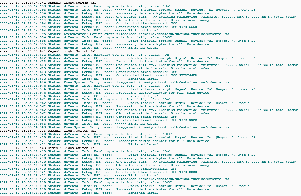

so i used above shown script:
Regen test is virtual sensors name
so letting this skript run it says:
so what am i missing??
Regen1 is my hardware name (Dummy)return
on =
devices =
"Regen1",
logging =
level = domoticz.LOG_DEBUG, -- INFO, ERROR or DEBUG
marker = "ESP test",
execute = function(dz, item)
local rainDevice = dz.devices("Regen test") -- Your (virtual) rain device
local rainSwitch = dz.devices("Regen1") -- Your (triggered by bucket full) switch
local rainmm = 0.45 -- find out what 1 bucket full means in terms of mm
local rainTotal = 0
local timeSlice = math.min( (rainDevice.lastUpdate.secondsAgo / 3600), 10) -- at least 1 bucket in 10 hours
local rainAmountHour = dz.utils.round((rainmm / timeSlice),1)
if item.active then
rainTotal = dz.utils.round((rainmm + rainDevice.rain),1)
rainDevice.updateRain(rainAmountHour, rainTotal)
dz.log("One bucket full ==>> updating raindevice. rainrate: " .. rainAmountHour .. " mm/hr, " .. rainTotal .." mm in total today ", dz.LOG_DEBUG )
rainSwitch.switchOff().silent()
"11" is the number of counts made by the swith today2022-08-14 10:37:12.810 Status: Warning: Expecting svalue with at least 2 elements separated by semicolon, 1 elements received ("11"), notification not sent (Hardware: 9 - Regen1, ID: 82018, Unit: 1, Type: 55 - Rain, SubType: 3 - TFA)

The devicet needs 2 values, rainAmountHour and Raintotal. So it looks like you do not send Raintotal. What does the log entry say?
Perhaps move the log line just above the rain device.updaterain line so you first get the log and the the error due to incorrect update.

I only was triggered on your error:
This means that Domoticz did not receive a proper update for the device and and Raintotal is empty.
So to debug change your current code
To
Now you would get first the log line in your domoticz log and then the error.
Expected log line (with other values of course):
"One bucket full ==>> updating raindevice. rainrate: 11 mm/hr, 10 mm in total today "
What dous it say in your case? Do you get bothe rainrate and raintotal?
Status: Warning: Expecting svalue with at least 2 elements separated by semicolon, 1 elements received ("11"), notification not sent (Hardware: 9 - Regen1, ID: 82018, Unit: 1, Type: 55 - Rain, SubType: 3 - TFA)So to debug change your current code
dz.log("One bucket full ==>> updating raindevice. rainrate: " .. rainAmountHour .. " mm/hr, " .. rainTotal .." mm in total today ", dz.LOG_DEBUG )Code: Select all

ok, so theres the problem
i do have a sonoff basic siwtch flashed with tasmota - chose a counter device to count than reed contact is working/bucket is tipping.
Changing it to a switch and setting up a virtual switch in domoticz the script works.
But one thing is not working (tried both ways with switched lines as well):
1bucket is 0,45mm. changing "2" to "0.45" its not adding 0,45, its adding -1,5..later adding 15 (switched lines -1,6) putting in 0,45 its adding -2.. or what ever ridiculous numbers..
- Posts: 6683
- Domoticz version: 2025.1
Re: Rain counter
That seems the same issue as somebody else already mentioned in this topic.....
According wiki it should be as below. DzVents is updating this accordingly.
Edit: So you have to send 0.45*100 = 45 when you want to send .45 mm/hr
/json.htm?type=command¶m=udevice&idx=IDX&nvalue=0&svalue=RAINRATE;RAINCOUNTER

so theres a picture of my Log
seems like its counting right, now and showing right decimals.
But its startnig wit 0 again an d again. An weather device keeps saying 0 while device in devices list keeps saying 0.45 for total rain
