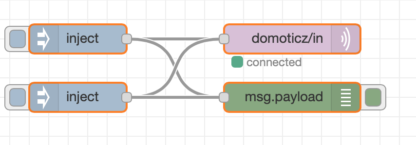

After a while I decided to use Node Red to connect with the Bosch Dishwasher.
I can now start/stop the dishwasher and can choose between differs programs with Node Red.
But now I have problems to connect a virtual switch in Domoticz that connect with MQTT to Node Red and start a program.
I have tested the connection between domoticz and Node Red. I can in Node Red put a switch on and off, and in Domoticz a light goes on and off.
So the connection between Node Red and Domoticz works perfect.
Is there someone with Node Red/ Domoticz experience to establish a switch function in domoticz that start a program from the dishwasher in Node Red?

@Knibor
I think that will be possible.
Before we start, I need some information.
The last picture represents a test to control a switch in Domoticz and you insert the correct payload with the 2 "Inject" nodes. I think we can forget this.
The first picture represents the "Home Connect" nodes from https://flows.nodered.org/node/node-red ... omeconnect. Correct?
Which version of Node Red do you use?
What do you inject with the different "Inject" nodes?
And what is the output of the different "Debug" nodes?
For the 4 different programs a selector switch might be the best option. Agree?
Awaiting your response.

Hi thanks for the response,
Yes, the first picture represents the "Home Connect" node from https://flows.nodered.org/node/node-red ... omeconnect.
The Version of Node Red is. V1.06
The different inject nodes are different dishwasher programs.
Inject Nodes "Stop" and the dishwasher Programms "Debug"
