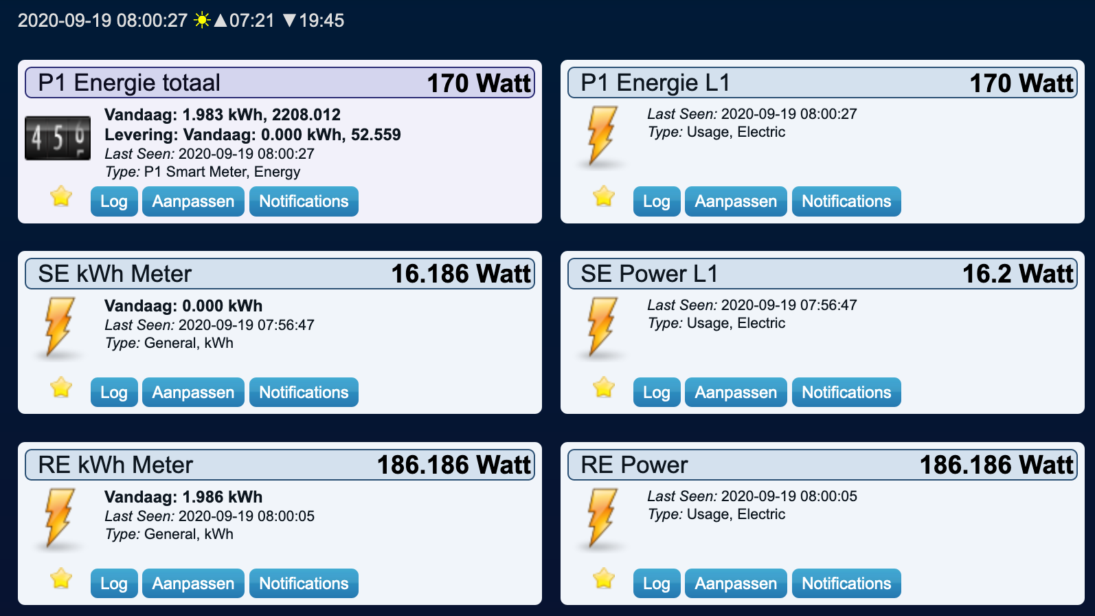

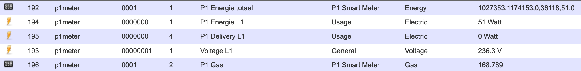

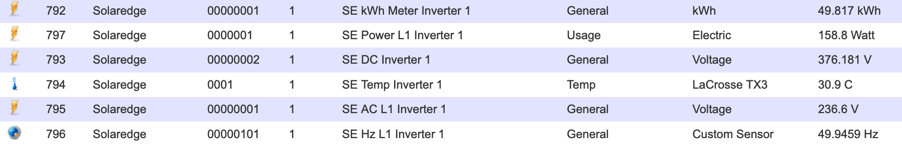

eddieb
Posts: 396
Joined: Wednesday 04 July 2018 7:48
Re: Calculating gross energy in dzVents
Post by eddieb »
waaren wrote: Sunday 30 August 2020 23:01
Hi Waaren,
I created the output device as kwh but that does not seem to work
What kind of devices should this all be ?
Eddie
RPI4 Beta / Tasmota / ZigBee2MQTT / P1meter / Haier AC MQTTmapper / SolarEdge SE3500H modbus_tcp / Marstek Venus / Opentherm gateway / Plugwise Anna/Smile / ObserverIP weatherstation thru WuDirect
Feeding ADSB https://adsb.im/home
eddieb wrote: Thursday 17 September 2020 17:23 I created the output device as kwh but that does not seem to work
There are more versions of this script. Which one do you you use? Please share and include resulting loglines.
Also please give some more detail on what you mean with output device. The script outputs to incremental counters and to virtual "usage (electric)" sensors
eddieb
Posts: 396
Post by eddieb »
waaren wrote: Thursday 17 September 2020 17:51 There are more versions of this script. Which one do you you use? Please share and include resulting loglines.
I just took the script in this thread. Did not know there were multiple versions.
I got my Solaredge panels a couple of days ago and just wanted to see the "normal" usage again ...
Before I started "delivering" the p1 output was enough for me but now that is not usable for this anymore ...
Any suggestions ?

@Waaren, my Solaredge produces the following devices :
Screenshot 2020-09-18 at 09.20.03.png (98.59 KiB) Viewed 2044 times
my p1 gives me
Screenshot 2020-09-18 at 09.20.19.png (81.1 KiB) Viewed 2044 times
Eddie

eddieb wrote: Friday 18 September 2020 9:22 @Waaren, my Solaredge produces the following devices :
my p1 gives me
Can you try with this one?

Tnx @waaren. It seems to work fine, just what I wanted !
Screenshot 2020-09-19 at 08.00.28.png (273.7 KiB) Viewed 1970 times
SE = SolarEdge
RE = calculated Real
exact code I used below,
tnx,
Eddie

        updateElectricity(realUsage, ( solarEnergy.WhTotal + P1.usage1 + P1.usage2 - P1.return1 - P1.return2 ) , ( P1.usage + solarEnergy.actualWatt - P1.usageDelivered )  )
        -- calculate usage with solarEnergy excluded
        updateEnergy(usageReal, solarEnergy.actualWatt + P1.usage - P1.usageDelivered )
