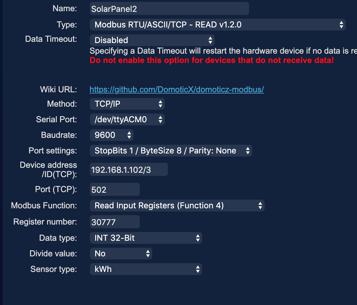

I'm using modbus-read (v1.2.0) , to retrieve the power generated by a SMA sunny boy 1.5 inverter with success. However when the power generated is zero (at night for instance), I start having negative values.

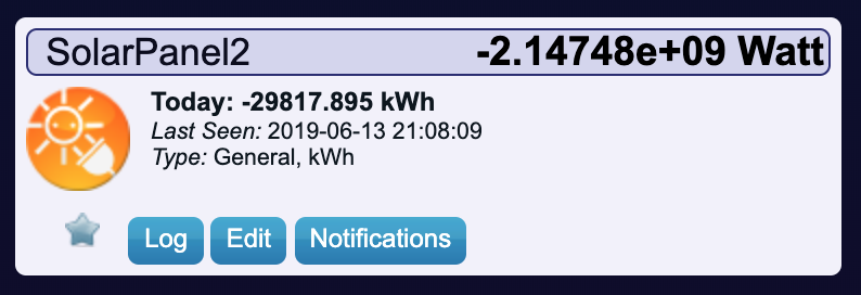

Screenshot in the end of a production day: (4w)
Example when the sensor should be zero:
Do you have any idea ... something I can adjust? Have you ever been through something similar?

Hello, I have got the same problem as yours.
The negative value you have is due to the fact than your solar system produce « 0 » and instead of sending « 0 » to Domoticz, it send an hexa value « 0x8000 0000 »; it corresponds in signed decimal to « -2147483648 ». This code corresponds to the NaN (not a number) value of your solar system; you should probably find it in the documentation of your solar system.
Here what I have done to get « 0 » instead of this negative value. As Domoticz doesn’t look like being able to deal with NaN value as it cannot be set as a parameter in the Domoticz configuration, nor in the plugin mod is I use, I have created a TRIGGER at DB level to change the negative value to « 0 ».
