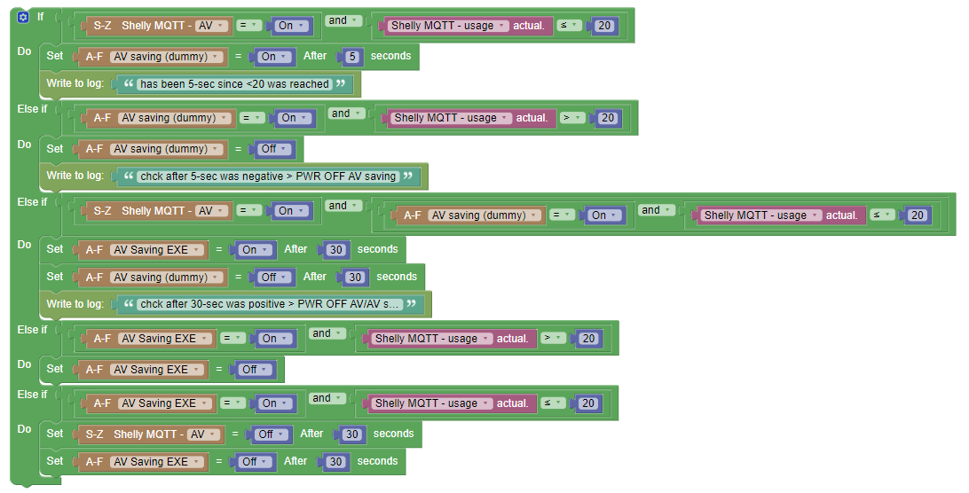

Hi All,
Since a couple of days i have my Raspberry running with Domoticz en MQTT of a Shelly Plug S and Shelly 1.
When it was working with the cloud function of Shelly i created a scene/event that had the following effect.
When the TV and peripherals are turned on the power consumption is always above 30Watts.
When the usage gets below 20 Watts the Shelly Plug S switches off after 20 minutes.
But when after (for example)15 minutes the usage increases above the 20 Watts level is just keeps ON.
I tried te re-create this with blockly and thought i fixed it. But when a timer has started i don't have a way to stop it.(even is i kill the dummy switch itself)
Is there a way to re-create this?
Thanks in advance :)
event 1.png (100.51 KiB) Viewed 392 times

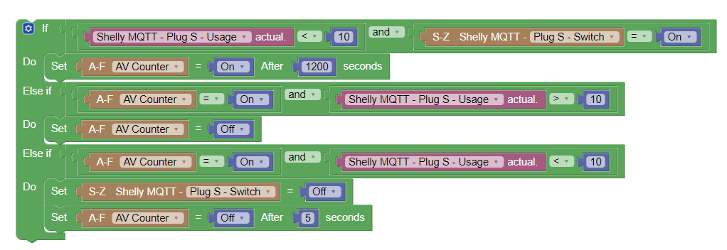

after browsing this forum a lot.
I found a different way to achieve it.
AV Saving.png (55.52 KiB) Viewed 366 times
