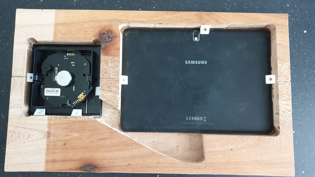

I use for several years Domoticz now and had also used an tablet on the wall to show the standard Dashboard of Domoticz.
Some weeks ago I started to play with Dashticz and made a nice new Dashboard. The options and the customization's are enormous.
Installed Fully Kiosk Browser and enabled the Motion detection. This only drains the battery in like a day. Hooked up a power cable but I don't like the cable in sight so I made a "Dashboard" out of wood to hold the thermostat and my tablet. Here the results.

Nice frame!

Fab! The idea of combining the thermostat and the tablet in one casing makes me reconsider my plans to place a tablet-only solution on the wall. Kudos! :mrgreen:
