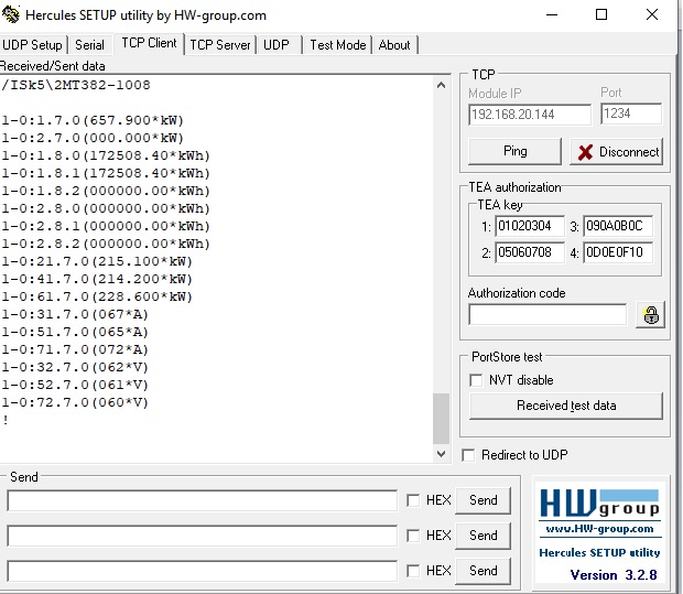

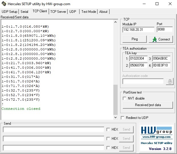

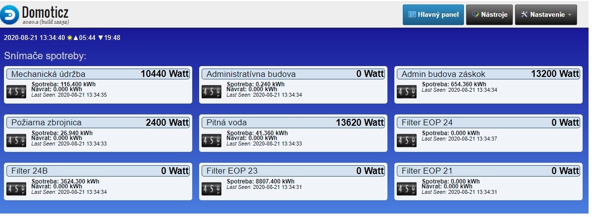

Greetings I have a question. In domoticz I monitor consumption on nine electricity meters via the p1 plugin, on four it shows me the current consumption and on five it does not, but they are shown in the graphs. In electricity meters, the correct setting for sending data is the same. When you check the package put in the home automation of the electricity meters the data is all fine but the domestic is not showing them all. Electricity meters: those that are displayed ISKRA MT382 D1 (direct measurement) and those that are not displayed ISKRA MT382 T1 (semi-direct measurement). Can't advise me how to resolve the Data? Domoticz runs on ubuntu 20.04 LTS servers.
ISKRA MT382 T1.jpg (112 KiB) Viewed 228 times
ISKRA MT382 D1.jpg (111 KiB) Viewed 228 times
