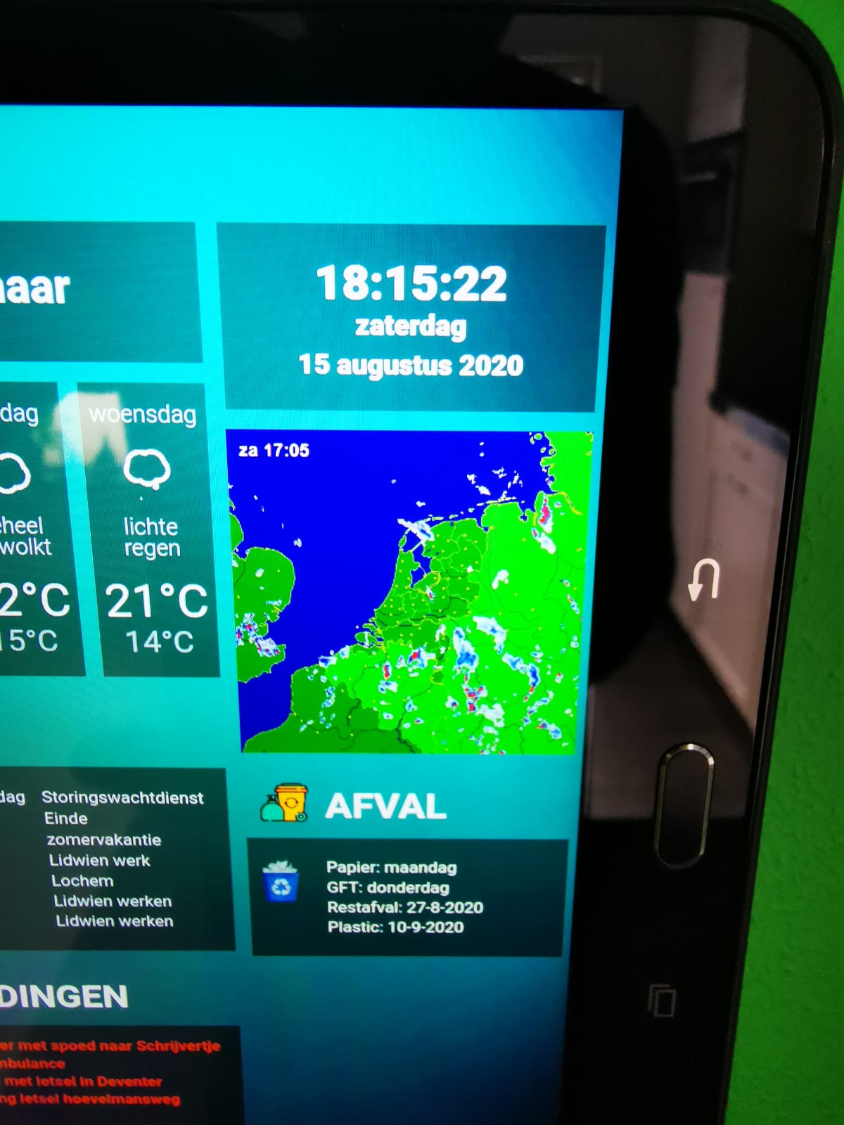

refreshtime of buienradar image
I thought that the refreshtime of the buienradar image was standard 60 seconds?
as you can see, mine is completely inaccurate (buienradar image of 17:05) and the time was 18:15,
so 70 minutes of not updating the image?
is this normal or is there a way to update this requently?
- buienradar.jpg (161.83 KiB) Viewed 1185 times

Can you send me the code of the buienradar ?

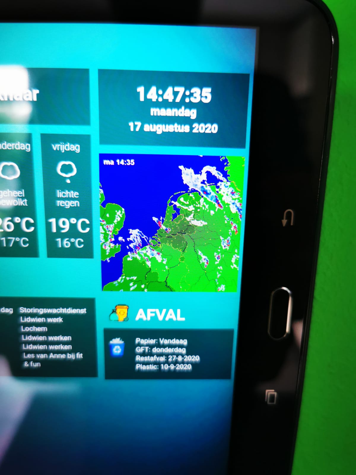

adding refreshimage:60 doesn't give a refresh of the image
not on the tablet and not on the laptop?
what is iframe? and does that give you a moving image of buienradar?

There is something wrong at the side of buienradar, the api.buienradar doesn't work, it also doesn't work if u use the url in a web browser.

Looks like they changed their image type. As far as I know was the old image a gif image and now it is a png image. The image is refreshed at buienradar site every 10 minutes.
This link: https://api.buienradar.nl/image/1.0/Ra ... =256&h=256 is working for me.

the api works again
