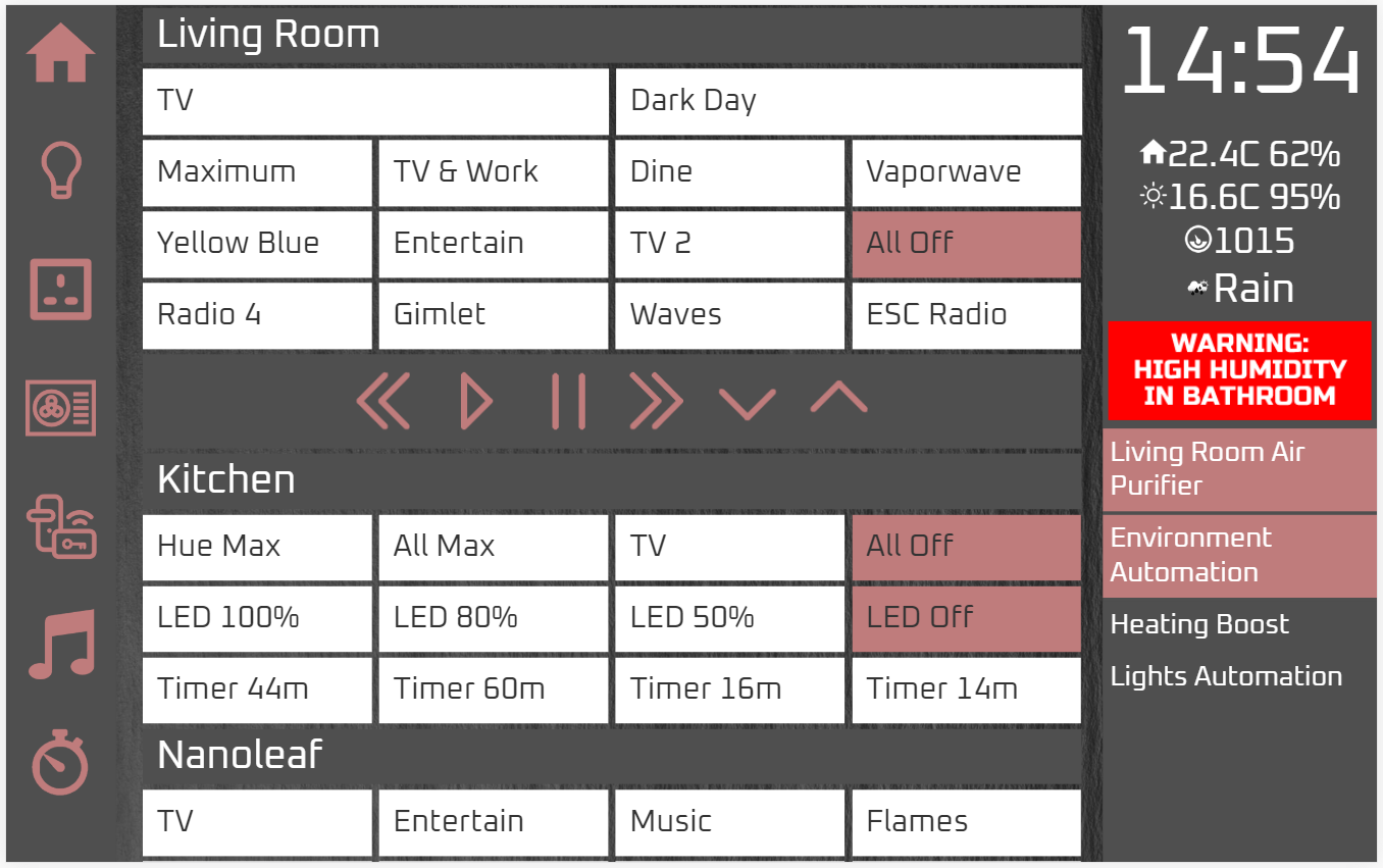

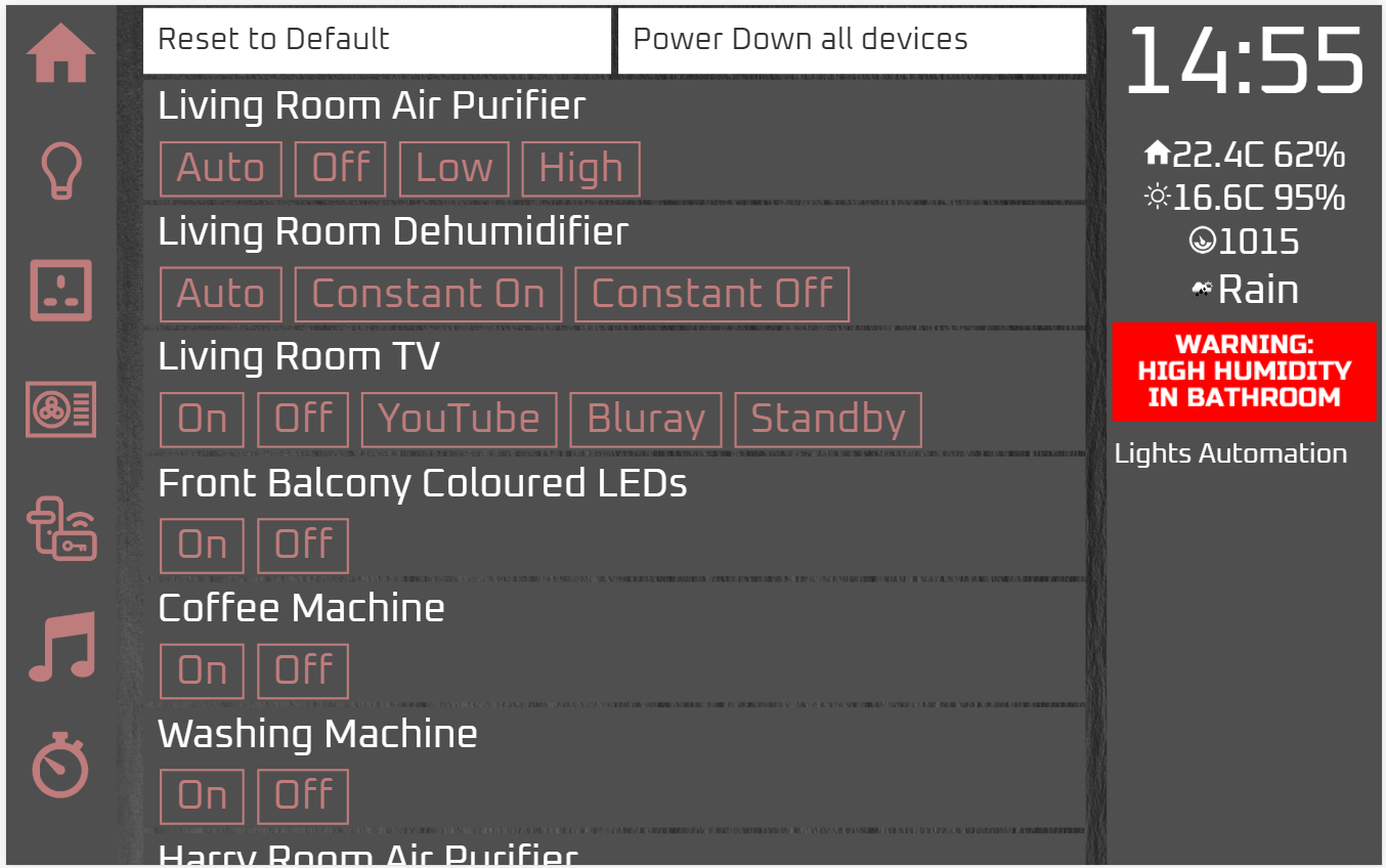

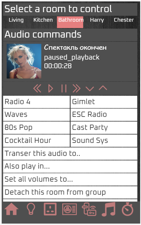

Hello all,
I have finished another version of my bespoke HTML front end template which is available at
https://github.com/fountside/domoticz-html-frontend
An accompanying YouTube video is available at
https://youtu.be/qgtygNnhQpQ
Please feel free to use any components from this HTML template for your own projects or you can download the CSS, start with the index.htm page and build your own multi-page panel. This front end is useful for homes where there are multiple (non-expert) users who will use static panels and smartphones as the template is auto-formatting to landscape and portrait screens.
I hope this is useful to someone out there, as it has taken a long time to refine the HTML and reusable JavaScript to get to this point. Thanks for reading.
Pure HTML/CSS Domoticz Interface
- Portrait 1
- ScreenCap4.png (138.31 KiB) Viewed 2195 times
- Landscape 2
- ScreenCap2.png (204.22 KiB) Viewed 2195 times
- Landscape 1
- ScreenCap1.png (257.34 KiB) Viewed 2195 times
