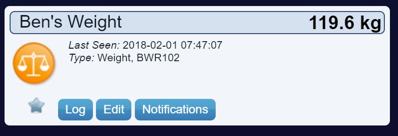

4) Create a new Virtual Sensor in Domoticz type "Scale (Weight)" and get its IDX code from the Domoticz devices page.
5) Enter the IDX number in the bash script, fill out the Domoticz configuration section and set the weight units in the script

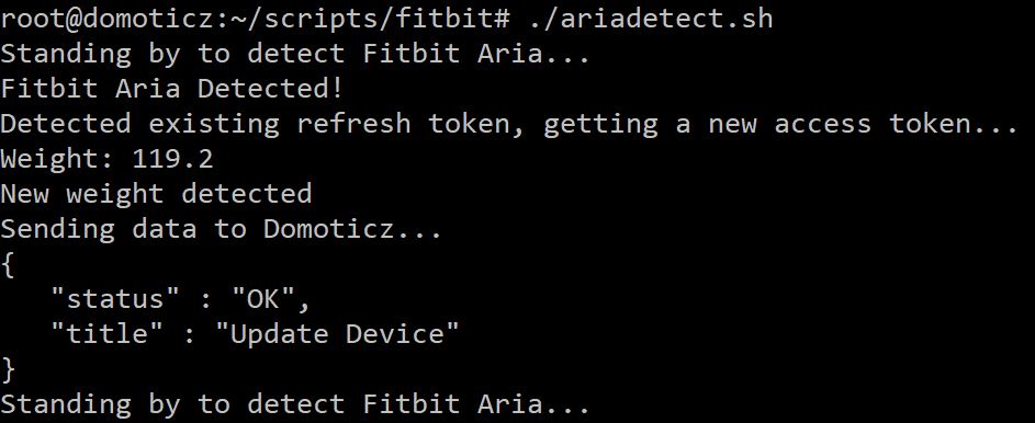

The terminal should look something like this:
Notes:
1) It is not recommended to use this version if your Domoticz server is connected to your WiFi router / access point via wireless. The script relies on low latency to be able to detect the Fitbit Aria during the brief time that it is connected to the network.
2) Do not use this version if you know your Fitbit Aria has a poor WiFi signal. If an Aria can't connect when you step on the scales, it will store the result and try again later. In this case you may as well use the first version of the script.
3) My observation is that an Aria is usually detected within about 30 seconds however it can take up to around 10 minutes for an Aria to be detected if it fails to update on WiFi during the first attempt. That said I have yet to see the script fail to detect an Aria, be patient, best results are achieved with a good WiFi signal.
