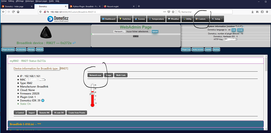

Some informations that could be usefull for you and others :
at first setup, default code is retreived depend of what device type you select on hardware page.
This should work for most devices but exceptions exist...
so, if the learning process do not work, do a 'network scan'.. this will retreive and display all Broadlink devices found on the network.

marchutt
Posts: 12
Joined: Monday 06 July 2020 5:12
Domoticz version: 2023.2
Re: Python Plugin : Broadlink
Post by marchutt »
Hello zak45,
Probably due to browser cache (try to open domoticz in private mode), if you take a look to the label of your device in the Web admin page, just after the few menu buttons, you should see : 0x5f36
Yep, that show now the right value.
click on it, wait few seconds and show your Domoticz log and the content of the files under log folder,
This de python error log when i use the network scan button
2020-08-08 19:02:37.364 (Broadlink) Succesvol verbonden.
2020-08-08 19:02:37.365 (Broadlink) onMessage heeft om verbinding gevraagd: 192.168.xxx.xx: 34748
2020-08-08 19:02:37.366 (Broadlink) We omzeilen URL-controle
2020-08-08 19:02:37.366 (Broadlink) data:b'{"status":{"step":"scan","msg":"Fout bij het ophalen van Broadlink-apparaten","code":"1"}}'
2020-08-08 19:02:37.366 (Broadlink) {"status":{"step":"scan","msg":"Fout bij het ophalen van Broadlink-apparaten","code":"1"}}
2020-08-08 19:02:37.366 (Broadlink) gegevens worden verwerkt...
2020-08-08 19:02:37.366 (Broadlink) scan--Fout bij het ophalen van Broadlink-apparaten--1
2020-08-08 19:02:37.367 (Broadlink) gegevensverwerking OK
2020-08-08 19:02:37.417 (Broadlink) onDisconnect verzocht om verbinding &#39;192.168.xxx.xx:34748&#39;
2020-08-08 19:02:37.418 (Broadlink) Serververbindingen:
2020-08-08 19:02:37.418 (Broadlink) --> 192.168.xxx.xx:58194'.
2020-08-08 19:02:37.418 (Broadlink) --> 192.168.xxx.xx:34748'.
2020-08-08 19:02:42.427 (Broadlink) Succesvol verbonden.
2020-08-08 19:02:42.427 (Broadlink) onMessage heeft om verbinding gevraagd: 192.168.xxx.xx: 34750
2020-08-08 19:02:42.428 (Broadlink) We omzeilen URL-controle
2020-08-08 19:02:42.428 (Broadlink) data:b'{"end":{"step":"scan","msg":"EINDE scan"}}'
2020-08-08 19:02:42.428 (Broadlink) {"end":{"step":"scan","msg":"EINDE scan"}}
2020-08-08 19:02:42.428 (Broadlink) gegevens worden verwerkt...
2020-08-08 19:02:42.443 (Broadlink) Update 1:'EINDE scan' (Broadlink - RM2M-Status)
2020-08-08 19:02:42.454 (Broadlink) Update 1:'On' (Broadlink - RM2M-Status)
2020-08-08 19:02:42.454 (Broadlink) gegevensverwerking OK
2020-08-08 19:02:42.506 (Broadlink) onDisconnect verzocht om verbinding &#39;192.168.xxx.xx:34750&#39;
2020-08-08 19:02:42.506 (Broadlink) Serververbindingen:
2020-08-08 19:02:42.506 (Broadlink) --> 192.168.xxx.xx:58194'.
2020-08-08 19:02:42.506 (Broadlink) --> 192.168.xxx.xx:34750'.
And the 13MainOutput.txt from log dir (13MainOutput.err was empty)
--------------------------------------Start-------------------------------------
STEP ==: scan --- 2020-08-08 19:02:22
Discovering...
Found 1broadlink devices ---2020-08-08 19:02:37
RM4
# broadlink_cli --type 0x5f36 --host 192.168.xxx.xx --mac xxxxxxxxxx
Device file data (to be used with --device @filename in broadlink_cli) :
0x5f36 192.168.xxx.xx xxxxxxxxx
File "/home/pi/domoticz/plugins/Broadlink/Dombroadlink.py", line 874, in <module>
brodevices = discover()
File "/home/pi/domoticz/plugins/Broadlink/Dombroadlink.py", line 377, in discover
print("temperature = {}".format(idevice.check_temperature()))
File "/usr/local/lib/python3.7/dist-packages/broadlink/__init__.py", line 705, in check_temperature
data = self._check_sensors(0x24)
File "/usr/local/lib/python3.7/dist-packages/broadlink/__init__.py", line 684, in _check_sensors
check_error(response[0x22:0x24])
File "/usr/local/lib/python3.7/dist-packages/broadlink/exceptions.py", line 97, in check_error
raise exception(error_code)
broadlink.exceptions.StorageError: The device storage is full
---------------------------------------END--------------------------------------
no.. just click on 'create device' and you will have a Domoticz device created automatically for you with the corresponding ini file linked to !!
I thought from start that there must be something like that, after reading the docs from the 'old' plugin.
My first expectation was that after saving the learned ini file, automaticly a device was added.
But nothing happend and no device added, so i did this linking manual after a lot of try and error... :roll:
I see also no button 'create device' at all, not in broadlink devices and not on admin page..

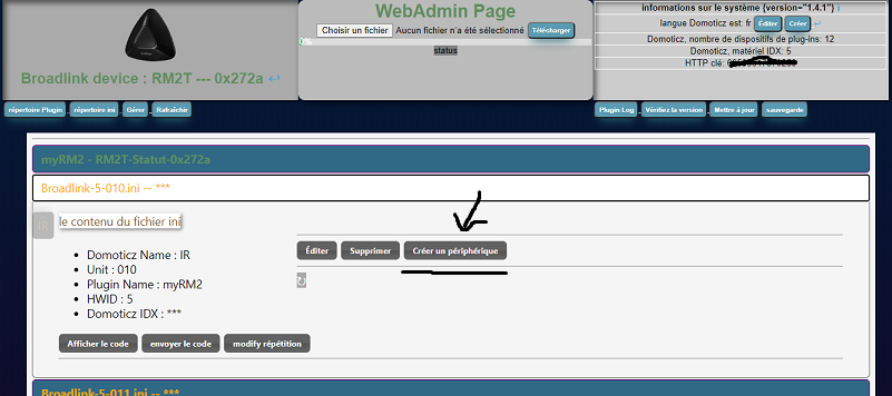

zak45
Posts: 954
Domoticz version: V2024.4
Post by zak45 »
thanks for the info... will take a look.
marchutt wrote: Saturday 08 August 2020 21:25
here it is :
just click on the ini fille you want to manage, and submenu should appear:
