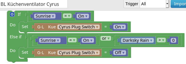

this is from domoticz stable, my first blockly that throw an error instead of switching the plug.
2020-08-01 14:31:36.284 Error: EventSystem: Lua script error (Blockly), Name: BL Küchenventilator Cyrus_2 => [string "result = 0; weekday = os.date('*t')['wday']; ..."]:1: ')' expected near 'comparevariable'
Have never seen such an error from a blockly, what can be wrong?

Post by knielen »
Both your if and your elseif have Sunrise = On. So both are always true.

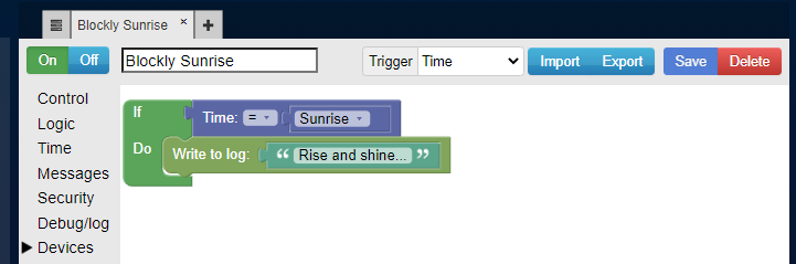

Re: Error from blockly that is dysfunctional
knielen wrote: Monday 03 August 2020 14:31 Both your if and your elseif have Sunrise = On. So both are always true.
Not quite.. Sunrise and Sunset are times. So never 'On' or 'Off'
It should be something like

Post by knielen »
waaren wrote: Monday 03 August 2020 15:10
Aah indeed, always hard to see errors when not programming yourself ;)
