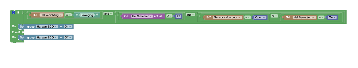

I would like one of my blocky scripts to be converted to dzVentz.
Can anyone help me to get this done properly?
Please find my attached screenshot of the blocky script I want to convert.

What are the types / subtypes of "Hal verlichting" and "Hal Schemer" as shown on the devices tab ?raymond1972 wrote: ↑Wednesday 29 July 2020 11:24 I would like one of my blocky scripts to be converted to dzVentz.

the device types are:
Hal verlichting : script device - light switch - selector switch
Hal schemer : zwave device - lux - lux
Sensor - Voordeur : zwave device - light switch - switch
Hal Beweging : zwave device - light switch - switch
set group Hal aan ECO : group
Kind Regards,
Raymond
Thank you for your quick response.

Re: Convert blocky script to dzVents
Please check spelling (case etc.. ) before saving
Could look like something below
return
on =
devices =
'Hal verlichting',
'Sensor - Voordeur',
'Hal Beweging',
logging =
level = domoticz.LOG_DEBUG, -- change to domoticz.LOG_ERROR when all is OK
marker = 'Hal beweging',
execute = function(dz, item)
local halLight = dz.devices('Hal verlichting')
local halTwilight = dz.devices('Hal Schemer')
local frontDoor= dz.devices('Sensor - Voordeur')
local halMotion = dz.devices('Hal Beweging')
local halECOGroup = dz.groups('Hal aan ECO')
if halLight.levelName == 'Beweging' and halTwilight.lux < 75 and frontDoor.state == 'Open' and halMotion.active then
halECOGroup.switchOn()
halECOGroup.switchOff()
