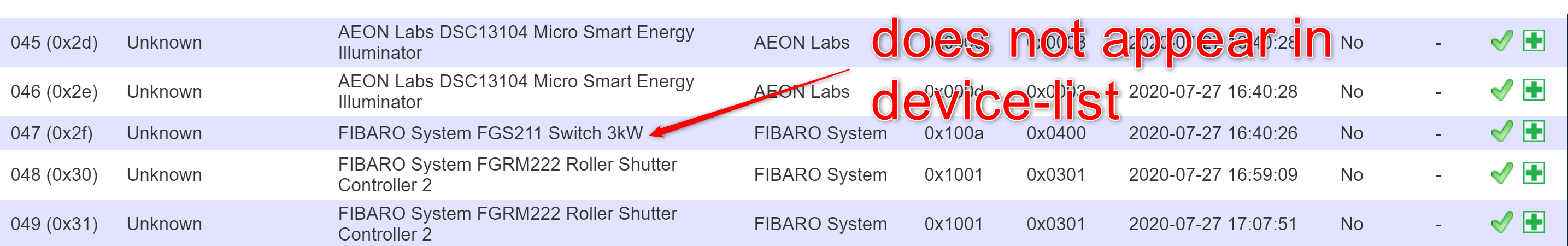

First I want to thank you for domoticz and this forum it helped me a lot.
I successfully installed domoticz on a raspberry pi with an aeon stick for zwave. I added the aeon stick to the existing vera zwave and switched it to be the master. All worked fine for the most of the switches.
Some switches do appear in the nodes list, but not in the device list. How can I add them to the device list? (for example the one on this screenshot)
What can I do ?

It was possibly a bug due to the switching from vera. I reincluded those devices and now they work fine.
