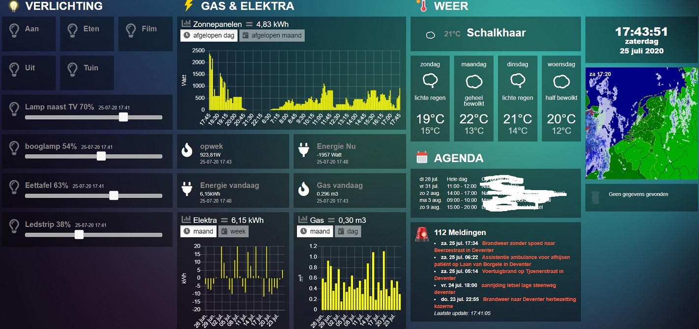

That's a nice dashboard. Complete overview of all utilities. Well done! ;)

I agree. Nice, easy layout. I especially like the energy-usage for the various devices. You use smartplugs for those?

Thanks! And of course many thanks to you and Lokonli (and some more people who worked on Dashticz) for your great work!
EdwinK wrote: Wednesday 03 June 2020 9:09 I agree. Nice, easy layout. I especially like the energy-usage for the various devices. You use smartplugs for those?
Thanks! I use Blitzwolf BW-SHP6 smartplugs which I flashed with Tasmota. They now give info to Domoticz via MQTT. They sell for about 13 euro's a piece on AliExpress. But I also tried a cheaper one (about 10 euro's) which I also succesfully flashed with Tasmota. I also have one for 8 euro's but with no power measure, only switching which I use for my garden lights.
Many plugs which work with the Tuya or Smartlife app will work. Compatible plugs you can find here: https://templates.blakadder.com/plug.html
They are really easy to flash with Tuya-convert using a Raspberry.

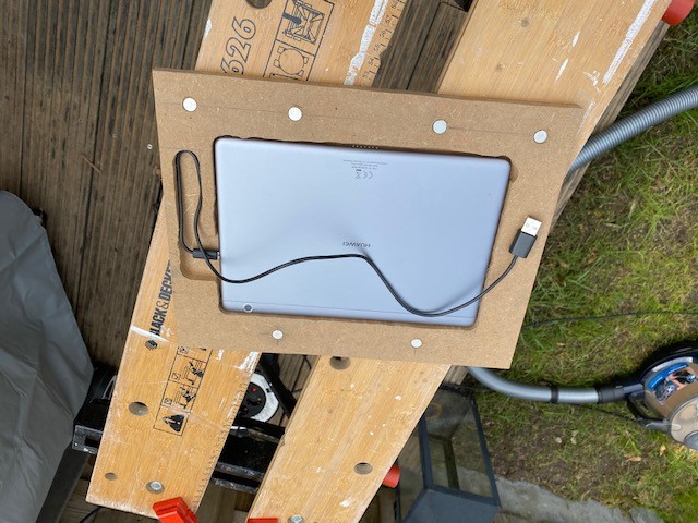

Two months ago I started with Dashticz. Domoticz is running for a few years now, and a user friendly dashboard in the living room is really nice. I like the way it is made, really good work! Thanks to everyone who is involved!
Also this forum was important to help me with some issues. Today I made the first topic with a question, so I think it is time to show my dashboard as well...
I made a frame of MDF and put some magnets in it so it sticks to a metal plate on the wall. On the other side of the wall there is a power outlet to charge the tablet. It is a Huawei T3 10"tablet, with the Fully Kiosk browser running.
At the moment it needs some fine tuning, and I need to add some more switches. Also the frame needs some fresh paint. Work in progress...

Great build! Might just inspire me to do something similar.

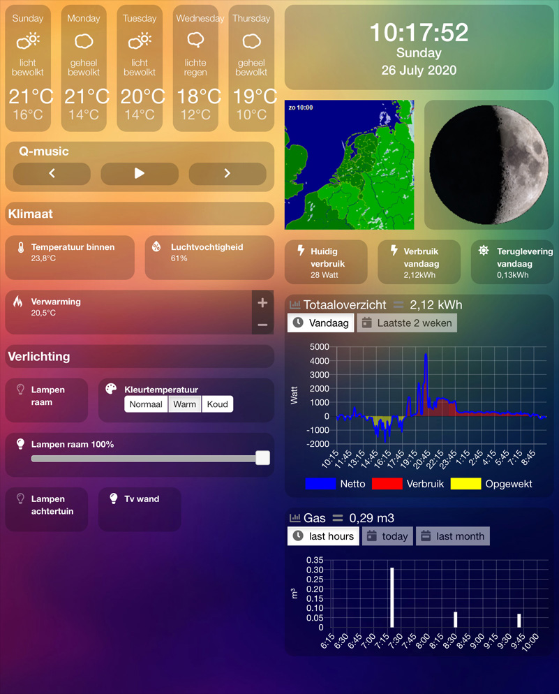

My first attempt creating a Dashticz dashboard! Still awaiting a couple of wifi power plugs to add and make some equipment smarter

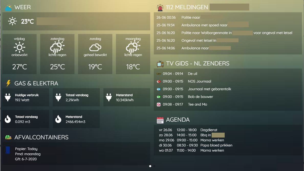

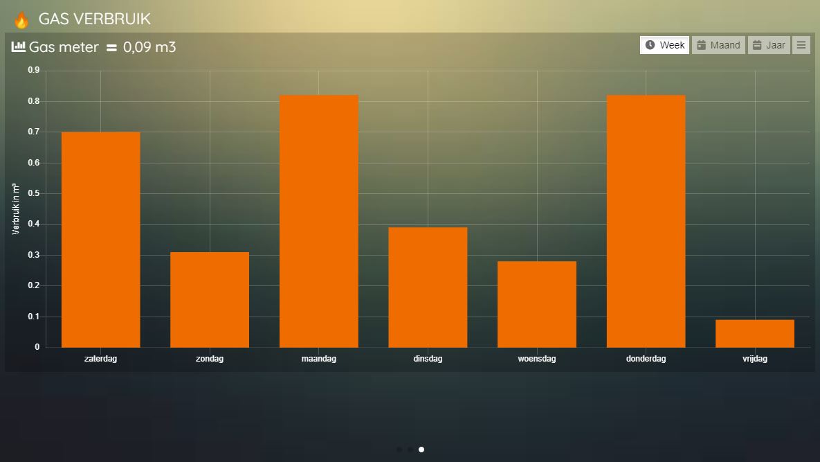

I just got started playing around with Domoticz and Dashticz. First thing I've done is connect the P1 smart meter to my Synology so Domoticz can read the values.
In a few months we move to a new home. I would like to extend my domotica there. Just gotta confince my wife that it is necessary :lol:
For now I've got my Dashboard like this:
I've created a virtual switch with Node-RED which casts the Dashboard to my Google Hub. Works like a charm.
What I would like to do is make a light theme. Haven't come to that yet.
For those who are interested, this is my configuration:

Almost done, this is how my dashboard has become 8-)
Very happy with it!
the only problem is the garbage collector that isn't working :cry:
EdwinK
Posts: 1820
Location: Rhoon
Post by EdwinK »
NilsNijenhuis wrote: Saturday 25 July 2020 17:49 Almost done, this is how my dashboard has become 8-)
Very happy with it!
Looks nice.

Here is my dashboard, not bad for someone with 0% coding skills :)
