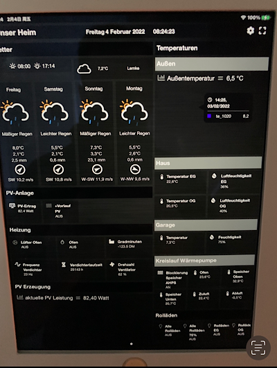

Mirkoser
- Posts: 32
- Joined: Tuesday 28 August 2018 15:36
- Domoticz version: 2021/1
- Location: Germany
Re: Strange behaviour with graphs after last update
maybe also the custum .css has an impact on that behaviour?
Here a picture from the dashboard
![Image]()

so here some more input. its getting stranger...so the graph disappear after a couple of hours as i already mentioned but if i do nothing it returns after a couple of hours....and so on ...
Any idea ?
