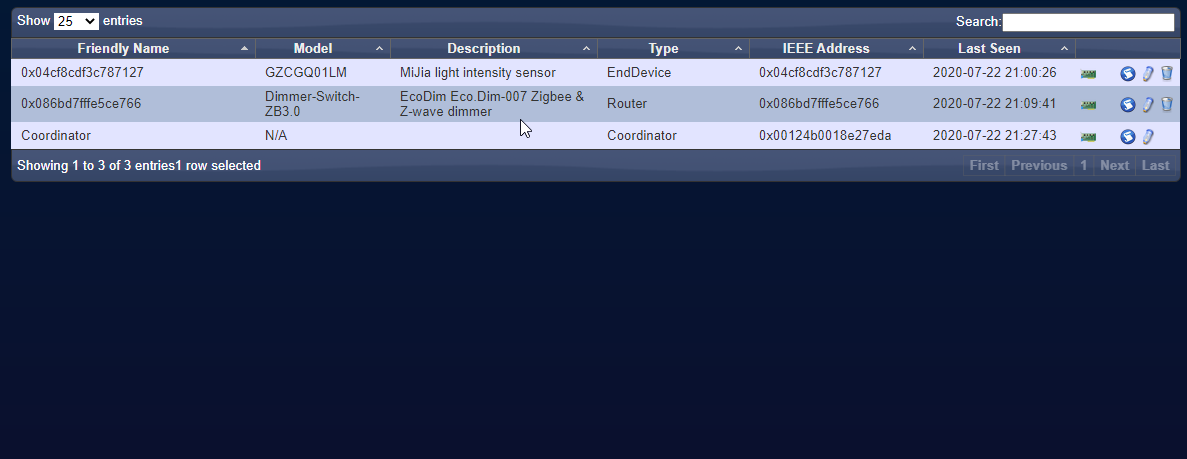

I recently bought this zigbee dimmer https://www.zigbee2mqtt.io/devices/Eco-Dim.07.html.
Its paired with a local running zigbee2mqtt server and recognised by the zigbee2mqtt plugin, but here comes the strange part.
But its not adding the correct devices. I think the cause is, its recognised as a router and not as a light switch.
Attached a screenshot of the zigbee2mqtt plugin administration panel. As you can see no devices are presented under the selected hardware.
Does anybody know a solution?
2020-07-22 21_27_53-Window.png (35.5 KiB) Viewed 5266 times

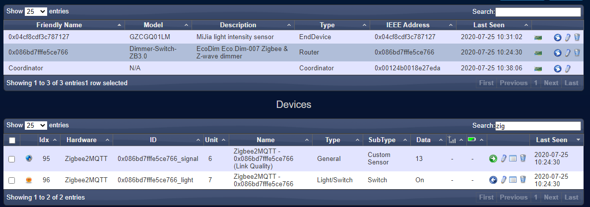

Fixed it myself :-)
The answer was adding the following line to [your directory]/domoticz/plugins/zigbee2mqtt/adapters/__init__.py
    #ECO.DIM (S10)
    'Dimmer-Switch-ZB3.0': DimmableBulbAdapter        # ECO.DIM dimmer
For anyone struggling with this, a simple explanation.
The file adapters__init__.py defines how to interpret the devices. In my case, the dimmer wasnt recognised and so i had to define how the plugin should see the new device.
Steps:
1. Search for the model (not modelid) of the new device in the zigbee2mqtt log file. In my case 'Dimmer-Switch-ZB3.0'.
2. Define the type of device it should act as. In my case 'DimmableBulbAdapter'
3. Restart domoticz.
4. The plugin should now see the new devices.
