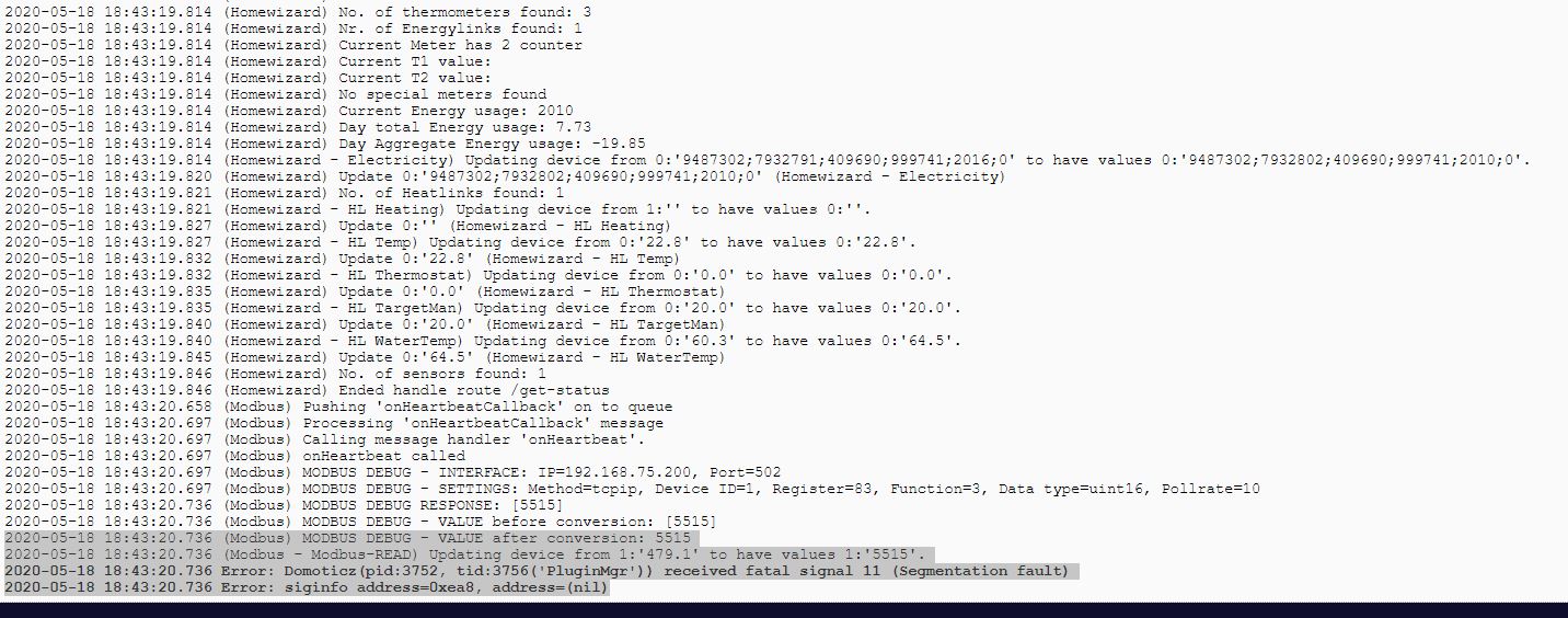

Domoticx wrote: Monday 18 May 2020 18:28 Strange indeed!
And if you try register address 83 or 85?
That's the problem. When is use 83 then the right value. Normal i use with de sniffer 84 :roll:
snooze7555
Posts: 8
Joined: Saturday 16 May 2020 17:35
Domoticz version: 2022.1
Location: Hengelo ov /NL
Re: Python plugin: Modbus RTU / ASCII / TCP/IP
Post by snooze7555 »
Hallo
It works, adress -1.
After 2 minutes then see attachment
Problem with domoticz. When i use custom the all ok
:D
