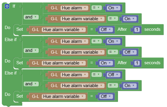

My domoticz main functionality is an alarm for my house. My first alarm light was a flash light controlled by a plug when my alarm would go off.
But why not use my Hue lights for this right? I started a script in dzVents, but that had some bugs. Now i have a Blockly setup witch is easier and more stable.
Here is what i did:
  • Create scenes in Hue app with the desired colors of the Hue lamps, for instance red (in my case 'Scene alarmscene' and 'Alarmscene keuken'). Add the scenes from devices to switches so you can use them in your Blockly (in my example i have two scenes, one for my kitchen and one for my living).
  • Create two dummy swithces and name them 'Hue alarm' and 'Hue variable'.
Now create the following three Blockly's.
The 'Alarm variable' will determine the blinking speed. I tried to let the Hue blink faster then 1 sec, but that doesn't realy work, you'll end up with irregulair blinking. I think Hue will not accept changes faster than a second.
Now you can switch the blinking on/off with switch 'Hue alarm'.
It can be done in two Blockly's without the 'Hue alarm variable' and control the Hue scenes directly, but this is more clearly for me.
Hope this is helpfull
Hue alarm 3.png (27.68 KiB) Viewed 936 times
Hue alarm 2.png (45.04 KiB) Viewed 936 times
Hue alarm 1.png (9.04 KiB) Viewed 936 times

i tried to make a dzvents, but the Hue response was not ok. The toggling caused the Hue to fail. it seems like it couldn't handle the quick switching commands. Weird, because with Blockly it is not a problem.
