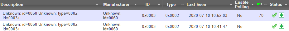

Hello I bought 4 Access Control Sensor EVERSPRING Z-Wave+ SM810
http://www.everspring.com/portfolio-ite ... ct-sensor/
It's work very weel but in domoticz / setup / hardware / setup they are unknow.
I could understand that we can update an xml file to add information.
May be one of you use SM810 without issues and can help me.
Thanks a lot
The message in the line is : Unknown: id=0060 Unknown: type=0002, id=0003+

Did you try to do a Node Heal in the Zwave devices listing (under Zwave controller device, press settings) - after the Heal command you have to wake up your Device (if I am correct and it is Battery-powered)

Hello @snowtiger
I did it but same behaviour.
Do you know where is the xml file with all zwave devices ?
thanks

Snowtiger wrote: Sunday 12 July 2020 16:10 Did you try to do a Node Heal in the Zwave devices listing (under Zwave controller device, press settings) - after the Heal command you have to wake up your Device (if I am correct and it is Battery-powered)
This has nothing to do with healing, the required .xml file is not present hence OZW cannot handle it. You need to create the .xml, also update the manufacturer_specific.xml or simply wait til the device gets supported.
@xavierlp: you need to follow the manual provided @ openzwave's github, it's quite simple to understand.

Post by xavierlp »
@LouiS22 thanks for the tip
So I updated the file manufacturer_specific.xml to add this line
<Product config="everspring/sm810.xml" id="0003" name="SM810 Door/Window Sensor" type="0002"/>
under
<Manufacturer id="0060" name="Everspring">
then add a file sm810.xml in the dir /home/pi/domoticz/Config/everspring
like this
<Product Revision="5" xmlns="https://github.com/OpenZWave/open-zwave">

To keep ID = 3 and type = 2
I used the sm103.xml file to have a model.
But it still the same ....
Anything that I missed ?

You need to remove the node, then readd.
Also, don't forget that once you update your domoticz, your contribution to the manufacturer_specific will be lost.

Perfect it's works :)
Thanks a lot
