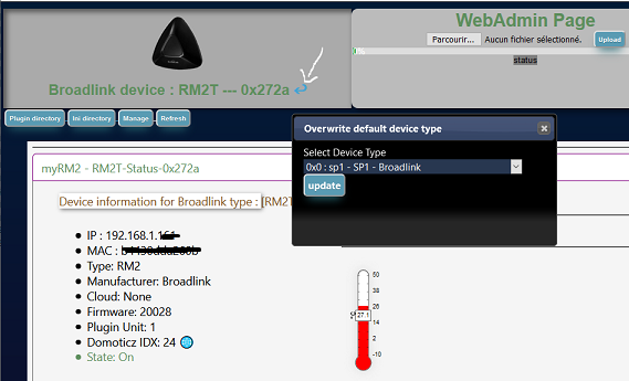

Version 1.1.0 uploaded:
# 1.1.0 : 13/07/2020
# modify broadlink_connect : use of broadlink.gendevice()
# possibility to overwrite the default device type
# display only ini file name + domoticz idx and not full path in manage()
to update:
to overwrite default device type:
