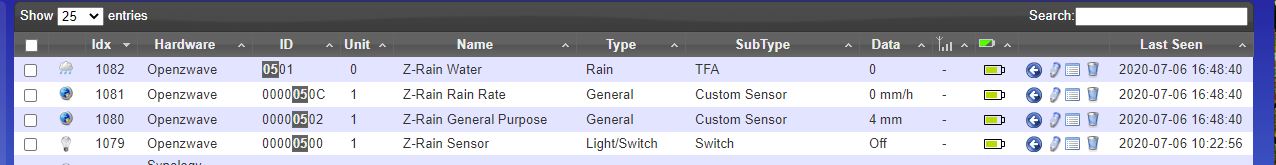

Hi I am trying to read the data of my Popp Rain Sensor shown below in my dzEvents script.
- device type = General
- subtype = Custom sensor
- Data = "4 mm" (see below)
how do I do that?

Re: How to read data of Popp Rain General Sensor  [Solved]
henrivb wrote: Tuesday 07 July 2020 9:51 Hi I am trying to read the data of my Popp Rain Sensor shown below in my dzEvents script.
how do I do that?
can you try this?
return
    on =
        devices =
            1080,
    logging =
        level = domoticz.LOG_DEBUG,
    execute = function(dz, item)
        local amount = item.sValue
        dz.log('Device ' .. item.name .. ' was updated to ' .. amount .. ' ' .. item.sensorUnit, dz.LOG_DEBUG)

It works! thanks
Here is my complete script to determine rainfall in the past 3 days using the Popp&Co 700168 Z-Rain ZWave device. I use this to determine if I need to rain my garden.
