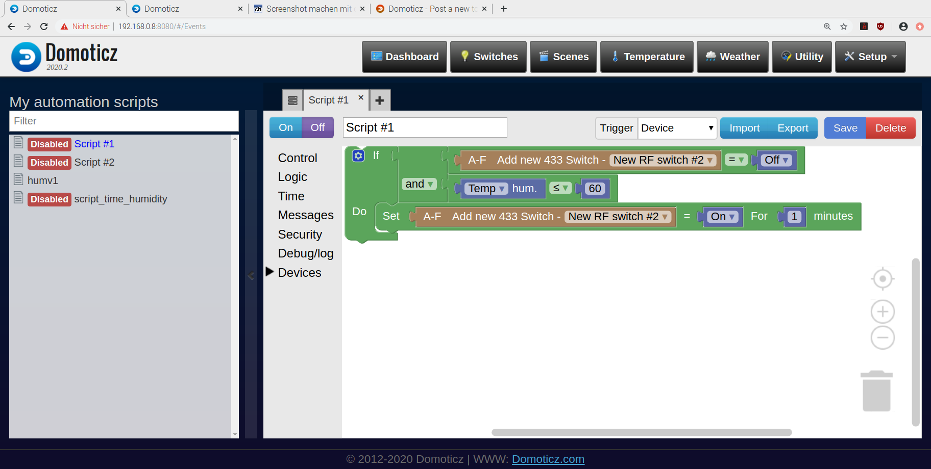

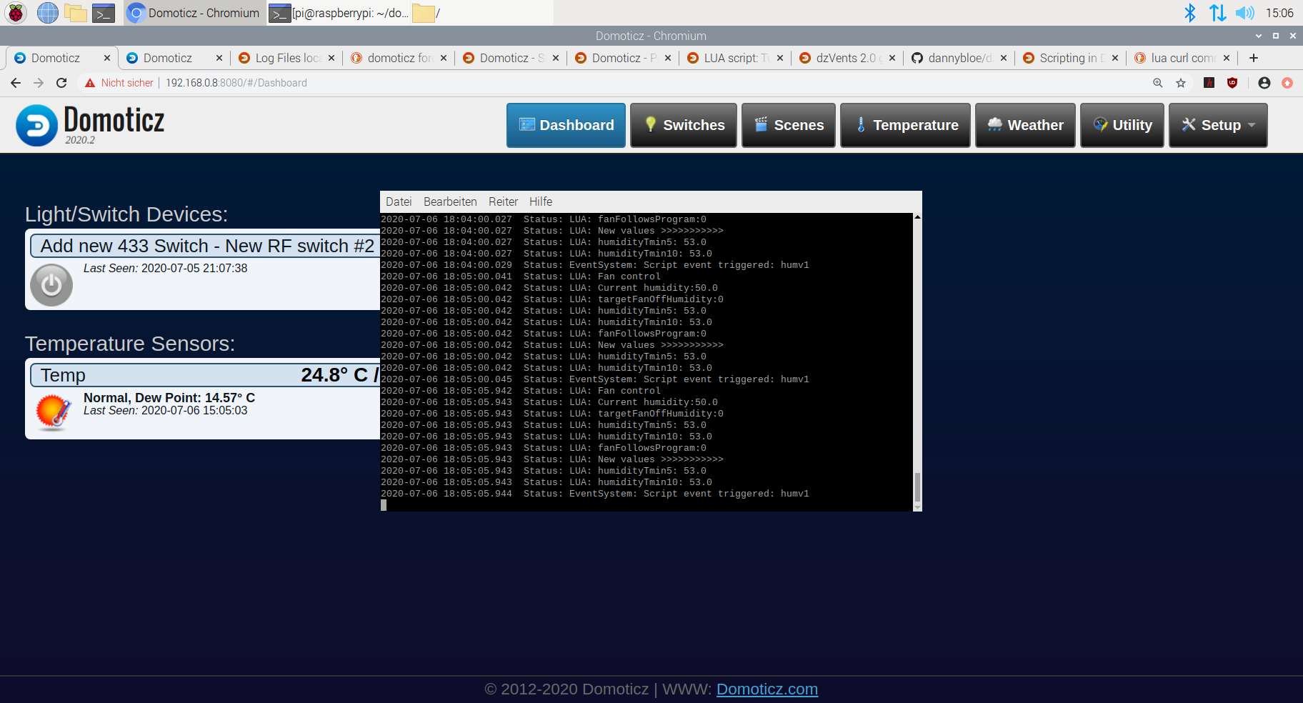

Hey Guys,
Im not sure where the problem is, i already played around for hours but im kinda stuck.
I did a little project on raspberry a few years ago, but seems like i forgot almost everything.
I am tryin to set a switch on or off at a certain humidity, i tried it with blockly and it once triggert the script and turned it on but only this one time :?:
I can turn it on or off at the dashboard but over the script no chance
i put in a screenshot of the dashboard with name of the sensor and switch, the log of the switch, the blockly thing and a lua script. It was ment to work with a fancontroller and i shortened it down. I get a trigger event in the log but switch activity.
would be nice if somebody can take a look and give a tip. Thanks in advance you guys !!!!!!!!

it worked, it turned the switch on 1 time. i changed values and saved it again. turned the lamp off manually restarted, no action. cronjob was created. when i run the script in cmd
~/domoticz/scripts/lua $ lua solar.lua
lua: solar.lua:17: attempt to index global 'otherdevices_temperature' (a nil value)
stack traceback:
solar.lua:17: in main chunk
[C]: ?
i compared the scripcts in the orignal it was otherdevices_humidity, so i changed it but same i treid to find it out but dont unstersant the solutions :roll:
pi@raspberrypi:~/domoticz/scripts/lua $ lua solar.lua
lua: solar.lua:17: attempt to index global 'otherdevices_humidity' (a nil value)
stack traceback:
[C]: ?
