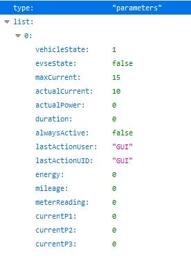

I have an EVSE-WiFi charging station for my new MG ZS EV.
What I want to do is:
I want to aks the EVSE-WiFi to give me al the information about its satus. http://192.168.x.x/getParameters
This JSON response looks like the screenshot.
EVSE-WiFi response.jpg (23.95 KiB) Viewed 3380 times
{"type":"parameters","list":[{"vehicleState":1,"evseState":false,"maxCurrent":15,"actualCurrent":10,"actualPower":0,"duration":0,"alwaysActive":false,"lastActionUser":"GUI","lastActionUID":"GUI","energy":0,"mileage":0,"meterReading":0,"currentP1":0,"currentP2":0,"currentP3":0}]}
