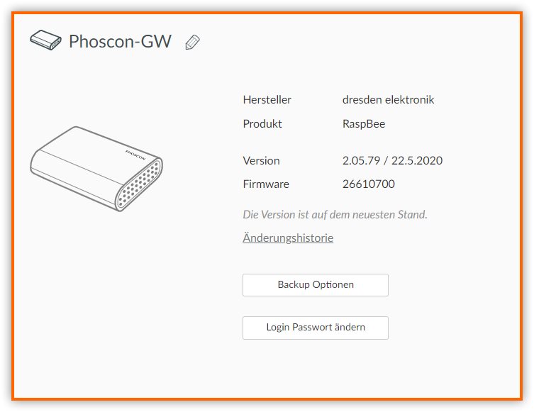

Hi, I keep getting error messages in the log.
device > 92 is my Raspbee-II
2020-07-19 22:25:49.766 Error: (deconz) Websocket error, unknow device > 92 (sensors) Asking for information

2
Why does Conbee2 appear there? And the FW is not right either.
2020-07-20 21:34:37.367 (deconz) Making Request : http://192.168.178.71:80/api/097DEDA817/lights/92 with params None
2020-07-20 21:34:37.384 (deconz) Request Return : {"etag":"7d4d08b8fe6f09436b1aa203f8d0c67b","hascolor":false,"lastannounced":null,"lastseen":"2020-07-20T19:34:37Z","manufacturername":"dresden elektronik","modelid":"ConBee II","name":"Configuration tool 92","state":{"reachable":true},"swversion":"0x264a0700","type":"Configuration tool","uniqueid":"00:21:2e:ff:ff:04:08:01-01"}
2020-07-20 21:34:37.384 (deconz) Classic Data : {'etag': '7d4d08b8fe6f09436b1aa203f8d0c67b', 'hascolor': False, 'lastannounced': None, 'lastseen': '2020-07-20T19:34:37Z', 'manufacturername': 'dresden elektronik', 'modelid': 'ConBee II', 'name': 'Configuration tool 92', 'state': {'reachable': True}, 'swversion': '0x264a0700', 'type': 'Configuration tool', 'uniqueid': '00:21:2e:ff:ff:04:08:01-01'}
2
- sshot-2.jpg (38.4 KiB) Viewed 2619 times
- Posts: 852
- Joined: Wednesday 15 August 2018 14:38
- Target OS: -
Re: Python Zigbee plugin, deCONZ bridge (Using Conbee or Raspbee)
Yes the conbee appaear in device list since 2 /3 version, but ignored by the plugin, so not visible in domoticz (but visible in phoscon)
And you have the last firmware from 08-Jun-2020, you haven't updated it since 2 month ?2020-07-20 21:34:37.385 (deconz) Skipping Device (Useless) : 00:21:2e:ff:ff:04:08:01-01
