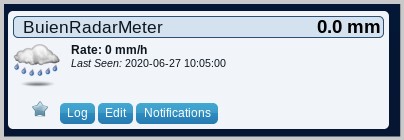

You posted image indicates that the update of device "BuienRadarMeter" doesn't happen each 5 minutes... so that is wrong!

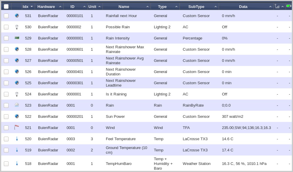

Have you tried simply using the internal available option for Buienradar to get that information when running the latest version of Domoticz?
These devices are generated when you Add the Hardware "BuienRadar":
As you can see, there is also a Wind sensor there and you can use that data to retrieve the windspeed and windgustspeed :
sDirectionDegrees, sDirection, sSpeed, sGust, sTemperature, sFeel = otherdevices_svalues['Wind']:match("([^;]+);([^;]+);([^;]+);([^;]+);([^;]+);([^;]+)")
Jos
