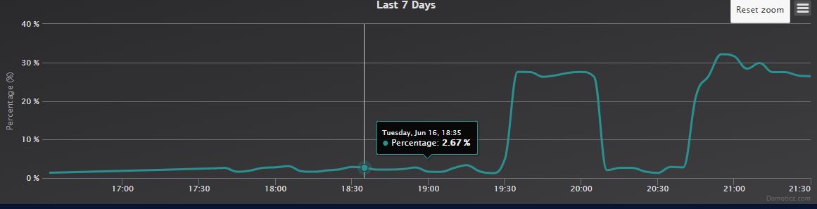

Normally, my RPI would run below ~2% CPU, but with the NefitEasyHttpServer load increases to 25-30% on average which increases the temperature of the RPI. I used to run Domoticz+Nefit on the same RPI with Stretch and the pre-2020 Domoticz version.
I'm using node v10.21.0, npm v6.14.4, for the nefiteasyhttpserver, I'm not sure about the version (how to check? With "sudo pm2 show nefiteasyhttpserver", the version is indicated as "N/A")
I'm assuming NefitEasyhttpServer is triggering the extra load, since if I disable it using ("sudo pm2 stop nefiteasyhttpserver") I note the CPU load (and the temperature) drop sharply, which is reversed when I enable it again ("sudo pm2 start nefiteasyhttpserver").
Here you can see the effect of starting and stopping the nefiteasyhttpserver; on around 19:30, off bot after 20:00, etc.
Probably, some additional information is required, which I will gladly provide, realizing that I'm quite far from the level many of the experts on this forum!

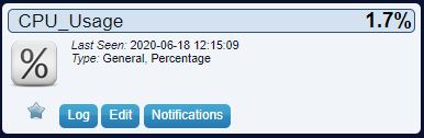

@FireWizard: thanks for your help, I have a correctly running system again with normal CPU load and temperature including support for Nefit Easy, running Raspbian Buster on RPI3B with Domoticz 2020.2 and all auto-starting after a reboot.
(I have to admin that the CPU hoovers between 1.5..3%, but this screen shot looks best
Bottom line, nothing wrong with easy-server as expected, just me-myself-and-I who had managed to mess up the setup somehow.
The high CPU load and related CPU temperature was caused by having multiple instances of easy-server running in parallel causing load problems.
I resolved this by removing/deleting/cleaning/uninstalling everything related to pm2 and easy-server, the removal tips you mentioned proved useful as well as the same issue mentioned here https://github.com/robertklep/nefit-easy-core/issues/19.
Then I picked the installation from https://www.domoticz.com/wiki/NefitEasy from "Install pm2 to control the service" onwards (no need to recreate the file nefiteasyhttpserver.sh; it was obviously still there.
I did use pm2 again, even though easy-server is the only node package running (or should I count npm and pm2 itself also?); I just followed the steps in the Nefit-easy wiki.
This might not have been the shortest and most practical solution, experts are likely able to correct the 'multiple instances issue' rather then my approach (delete, clean up and reinstall). But it did the job. This forum is a great resource. Thanks!
