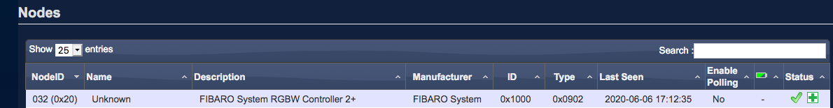

I want to read voltage value from analog input at FIBARO System RGBW Controller 2.
What I did so far:
Now I see in 'hardware section':
Schermafbeelding 2020-06-06 om 17.23.26.png (43.25 KiB) Viewed 504 times
Nice!
