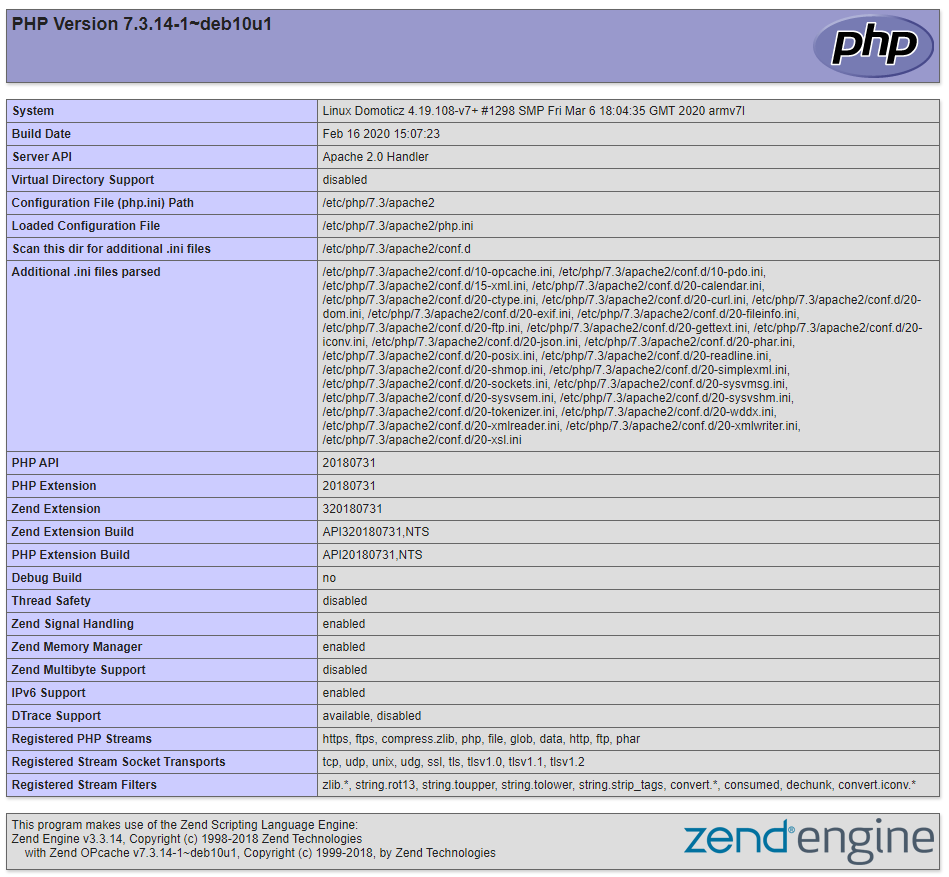

Can you check if PHP is enabled?
For more info see: https://dashticz.readthedocs.io/en/beta ... stall.html
Blah blah blah
Kencirot
- Posts: 5
- Joined: Wednesday 05 June 2019 14:52
Re: Dashticz - Module - Garbage collector
Yes, it is.
Index.php with
on apache working perfect when I visit with a browser.
Index.php with
<?php echo "hello world"; ?>- Attachments
- phpinfo.PNG (85.63 KiB) Viewed 2994 times

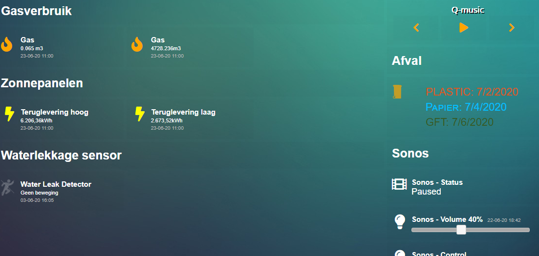

I have been playing with dashticz for about 5 weeks now and I'm very happy with the possibilities!
I already introduced it to the family with a tablet which is always on in the living-room with home automation control and info like public-transport, family agenda, links to school information pages etc...
But 1 thing I really want to get up and running is the garbage calendar.
The issue is specific to Meerlanden and my adres. If I use i.e. omrin and an address in Leeuwarden It works.
My address is 1432PC 49...
For testing I use the latest beta version (3.4.9.1).
For the family page I have the master version running.
I hope someone can help me out.
Rgrds,
Jacco.

Thanks to this forum I was able to create my own Dashticz dashboard with all kind of plugins. One of them is the garbage collector.
Works like a charm (De Afval App) but the prefix is in English format while every setting is in 'nl_NL'. Can someone tell me how to change this in Dutch date prefix?
EDIT: Nevermind. Got it fixed!
