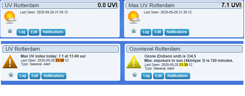

Here you go...
Probably some quite old constructs in the script because I have not touched it since a long time but it is still functional.
--[[ openUV.lua for [ dzVents >= 2.4 ]
    on      =   {   timer           =   { "every 30 minutes at daytime" }, -- Triggers the getJsonPart
                    httpResponses   =   { "openUV_Response" }               -- Trigger the handle Json part
    logging =   {   level     =   domoticz.LOG_ERROR,
                    marker    =   "openUV"
    data    =   {   openUV_Longitude          = {initial = "4.51234"                           },  -- I store my longitude, latitude, APIkey, filename in data
                    openUV_Latitude           = {initial = "51.81234"                          },  -- You can get them from domoticz settings
                    openUV_Filename           = {initial = "scripts/dzVents/data/OpenUV.json"   },  -- path relative to domoticz directory
                    openUV_APIKey             = {initial = "8xxxxxxxxxxxxd5e004ea781"   },  -- get your free API key from https://www.openuv.io/
                    openUV_currentUV_device   = {initial = 887                                  },  -- You have to create a couple of virtual devices
                    openUV_maxUV_device       = {initial = 888                                  },  -- (first two as UV sensors and other two as Alert)
                    openUV_UV_Alert_device    = {initial = 894                                  },  -- Remember device ID"s and replace the "xxx" with them
                    openUV_ozone_Alert_device = {initial = 895                                  },  -- Look at https://www.domoticz.com/wiki/Hardware_Setup#Dummy_Hardware
    execute = function(dz, trigger)
        local function UV_Index2Alert(index)                            -- Levels as from KNMI
            local alert = dz.ALERTLEVEL_RED
            if      index < 3 then alert = dz.ALERTLEVEL_GREY
            elseif  index < 5 then alert = dz.ALERTLEVEL_GREEN
            elseif  index < 7 then alert = dz.ALERTLEVEL_YELLOW
            elseif  index < 9 then alert = dz.ALERTLEVEL_ORANGE
            return alert
        local function ozone2Alert(value)                               -- Levels as found on various WIKI pages
            if      value > 400 then alert = dz.ALERTLEVEL_GREY
            elseif  value > 340 then alert = dz.ALERTLEVEL_GREEN
            elseif  value > 310 then alert = dz.ALERTLEVEL_YELLOW
            elseif  value > 280 then alert = dz.ALERTLEVEL_ORANGE
            return alert
        local function getOpenUV_json()
            local openUV_url        = "https://api.openuv.io/api/v1/uv?lat=" .. dz.data.openUV_Latitude .. "&lng=" .. dz.data.openUV_Longitude
             dz.openURL({
                            url = openUV_url ,
                            method = "GET",
                            callback = "openUV_Response",
                            headers = { ['x-access-token'] =  dz.data.openUV_APIKey },
        local function handleOpenUVResponse()
            -- Read response into table and close file
            openUVResponse      = trigger.json
            dz.log(openUVResponse,dz.LOG_DEBUG)
            if openUVResponse == nil or
               openUVResponse.result.uv                      == nil or
               openUVResponse.result.uv_max                  == nil or
               openUVResponse.result.uv_max_time             == nil or
               openUVResponse.result.ozone                   == nil or
               openUVResponse.result.safe_exposure_time.st3  == nil then
               dz.log("Some values are missing; check it out",dz.LOG_ERROR)
               dz.log(openUVResponse,dz.LOG_ERROR)
               return
            -- Update UV devices
            dz.devices(dz.data.openUV_currentUV_device).updateUV(dz.utils.round(openUVResponse.result.uv,1))
            dz.devices(dz.data.openUV_maxUV_device).updateUV(dz.utils.round(openUVResponse.result.uv_max,1))
            -- convert to local time
            local commandString     = "date -d " .. openUVResponse.result.uv_max_time ..  "  '+%k:%M uur' "
            local dateOutput        = assert(io.popen(commandString))
            local openUVMaxUVtime   = dateOutput:read("*all")
            dateOutput:close()
            -- Construct Alertlevel and text and update UV alert device (type = Alert)
            UV_AlertText = "Max UV index today: " .. dz.utils.round(openUVResponse.result.uv_max,1) .. " at " .. openUVMaxUVtime
            dz.log("Current UV index = " .. dz.utils.round(openUVResponse.result.uv,1) .. ", " ..  UV_AlertText,dz.LOG_INFO)
            dz.devices(dz.data.openUV_UV_Alert_device).updateAlertSensor(UV_Index2Alert(openUVResponse.result.uv_max), UV_AlertText)
            -- Construct Alertlevel and text and update ozone alert device (type = Alert)
            ozoneAlertText = "Ozone (Dobson unit) is " .. openUVResponse.result.ozone .. "\n Max. exposure to sun (Skintype 3) is " ..
                            math.min(openUVResponse.result.safe_exposure_time.st3,720) .. " minutes."
            dz.log(ozoneAlertText,dz.LOG_INFO)
            dz.devices(dz.data.openUV_ozone_Alert_device).updateAlertSensor(ozone2Alert(openUVResponse.result.ozone), ozoneAlertText)
        if trigger.isTimer or trigger.isDevice then
            getOpenUV_json()

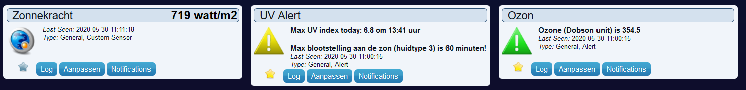

:D For me waaren's script works like a breeze
= Quick start to get hold of the values in the JSON-file
[Planned for generation (in RRDTool) of reference curve for my own UV-sensors, and for display of some values at my website]

@ Waaren,
Thank you for sharing your script. I want to customize the script.
I want to get rid of the blank line between "Max UV index today ... and Max exposure ...", no success.
            UV_AlertText = "Max UV index today: " .. dz.utils.round(openUVResponse.result.uv_max,1) .. " om " .. openUVMaxUVtime .."\n Max blootstelling aan de zon (huidtype 3) is " ..
                            math.min(openUVResponse.result.safe_exposure_time.st3,720) .. " minuten!"
Is it possible to avoid this blank line, if so how?
Thanks in advance!
Re: UV index readings realtime
Jan Jansen wrote: Saturday 30 May 2020 14:13 Is it possible to avoid this blank line, if so how?
If you remove the \n before Max blootstelling you wont' have the blank line
