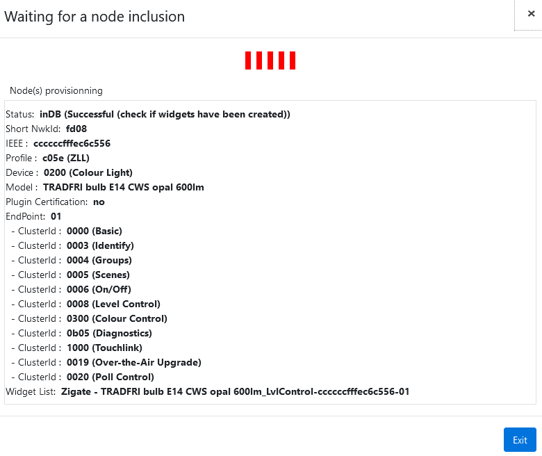

Hello!
I bought a couple of IKEA bulbs, E27 Opal and E14 Opal. The E27's show up in Domoticz as RGB and there is a color selector etc, but the E14's show up as Light/Switch and I can only turn them on/off and use the dimmer. If I only pair them to the Ikea Tradfri remote, they change color fine.
Tried several times to readd them. Last time I deleted them from domoticz (trashcan), did a reset on the light bulb, restarted zigate hw and domoticz, paired zigate to the bulb and it still ended up as a light/switch.
How can I make it register as RGB?
MaxLoad on ZiGate : 9
Plugin version: 4.7.010 stable
Firmware version: 031c
Domoticz version: 2020.2 stable
zigate plugin incl
zigate plugin incl

2020-05-26 21:05:46.563 (Zigate) Creation Group
2020-05-26 21:05:46.544 Status: (Zigate) [2] NEW OBJECT: fd08 Model Name: TRADFRI bulb E14 CWS opal 600lm
2020-05-26 21:05:47.821 (Zigate) UpdateDevice - (Zigate - TRADFRI bulb E14 CWS opal 600lm_LvlControl-ccccccfffec6c556-01) 1:100

I did a full zigate reset (erase PDM) and added a E27 and E14 but got exactly the same thing. I noticed that the E14 has a bunch of warnings (as in the log above).
I also added some cheap LED strip from chiina and it has the same thing, bunch of warnings and no RGB.
LED Strip:

Working E27 bulb:
2020-05-26 23:44:20.288 (Zigate) --> Empty queue
2020-05-26 23:44:21.717 (Zigate) --> Adding device ff65 in self.DevicesInPairingMode
2020-05-26 23:44:21.717 (Zigate) --> ['ff65']
2020-05-26 23:44:21.716 Status: (Zigate) Device Announcement Addr: ff65, IEEE: 680ae2fffea478b1 Join Flag: 0x00 - join a network through association RSSI: 0
2020-05-26 23:44:30.316 (Zigate) Assisted Pairing: Polling: ['ff65']
2020-05-26 23:44:30.316 (Zigate) --> New device: ff65
2020-05-26 23:44:35.251 (RFXtrx433E) Temp (Temp outside (neigh))
2020-05-26 23:44:36.589 Status: (Zigate) [0] NEW OBJECT: ff65 TimeOut in 0045 restarting at 0x004d
2020-05-26 23:44:36.700 Status: (Zigate) [-] NEW OBJECT: ff65 Active Endpoint Response Ep: 01 RSSI: 192
2020-05-26 23:44:36.700 Status: (Zigate) [-] NEW OBJECT: ff65 Request Simple Descriptor for Ep: 01
2020-05-26 23:44:36.803 Status: (Zigate) [-] NEW OBJECT: ff65 Simple Descriptor Response EP: 0x01 RSSI: 192
2020-05-26 23:44:36.803 Status: (Zigate) [-] NEW OBJECT: ff65 ProfileID c05e
2020-05-26 23:44:36.804 Status: (Zigate) [-] NEW OBJECT: ff65 ZDeviceID 0200
2020-05-26 23:44:36.804 Status: (Zigate) [-] NEW OBJECT: ff65 Application Version 0000
2020-05-26 23:44:36.804 Status: (Zigate) [-] NEW OBJECT: ff65 Cluster IN Count: 09
2020-05-26 23:44:36.804 Status: (Zigate) [-] NEW OBJECT: ff65 Cluster In 1: 0000 (Basic)
2020-05-26 23:44:36.804 Status: (Zigate) [-] NEW OBJECT: ff65 Cluster In 2: 0003 (Identify)
2020-05-26 23:44:36.804 Status: (Zigate) [-] NEW OBJECT: ff65 Cluster In 3: 0004 (Groups)
2020-05-26 23:44:36.804 Status: (Zigate) [-] NEW OBJECT: ff65 Cluster In 4: 0005 (Scenes)
2020-05-26 23:44:36.804 Status: (Zigate) [-] NEW OBJECT: ff65 Cluster In 5: 0006 (On/Off)
2020-05-26 23:44:36.804 Status: (Zigate) [-] NEW OBJECT: ff65 Cluster In 6: 0008 (Level Control)
2020-05-26 23:44:36.804 Status: (Zigate) [-] NEW OBJECT: ff65 Cluster In 7: 0300 (Colour Control)
2020-05-26 23:44:36.804 Status: (Zigate) [-] NEW OBJECT: ff65 Cluster In 8: 0b05 (Diagnostics)
2020-05-26 23:44:36.804 Status: (Zigate) [-] NEW OBJECT: ff65 Cluster In 9: 1000 (Touchlink)
2020-05-26 23:44:36.804 Status: (Zigate) [-] NEW OBJECT: ff65 Cluster OUT Count: 04
2020-05-26 23:44:36.804 Status: (Zigate) [-] NEW OBJECT: ff65 Cluster Out 1: 0005 (Scenes)
2020-05-26 23:44:36.804 Status: (Zigate) [-] NEW OBJECT: ff65 Cluster Out 2: 0019 (Over-the-Air Upgrade)
2020-05-26 23:44:36.804 Status: (Zigate) [-] NEW OBJECT: ff65 Cluster Out 3: 0020 (Poll Control)
2020-05-26 23:44:36.804 Status: (Zigate) [-] NEW OBJECT: ff65 Cluster Out 4: 1000 (Touchlink)
2020-05-26 23:44:40.299 (Zigate) Assisted Pairing: Polling: ['ff65']
2020-05-26 23:44:40.299 (Zigate) --> New device: ff65
2020-05-26 23:44:41.612 Status: (Zigate) [1] NEW OBJECT: ff65 Request Node Descriptor
2020-05-26 23:44:41.612 Status: (Zigate) [1] NEW OBJECT: ff65 Request Attribute for Cluster 0x0300 to get ColorMode
2020-05-26 23:44:46.616 (Zigate) Creation Group
2020-05-26 23:44:46.592 Status: (Zigate) [2] NEW OBJECT: ff65 Model Name: TRADFRI bulb E27 CWS opal 600lm
2020-05-26 23:44:47.731 (Zigate) UpdateDevice - (Zigate - LED1624G9_ColorControlRGB-680ae2fffea478b1-01) 1:100
2020-05-26 23:44:50.305 (Zigate) Assisted Pairing: Polling: ['ff65']
2020-05-26 23:44:50.305 (Zigate) --> New device: ff65
2020-05-26 23:44:50.305 (Zigate) --> inDB , removed ff65 from List
2020-05-26 23:44:50.305 (Zigate) ------> New Cluster: {'ClusterId': '0000', 'ClusterDesc': 'Basic'}
2020-05-26 23:44:50.306 (Zigate) ------> New Cluster: {'ClusterId': '0003', 'ClusterDesc': 'Identify'}
2020-05-26 23:44:50.306 (Zigate) ------> New Cluster: {'ClusterId': '0004', 'ClusterDesc': 'Groups'}
2020-05-26 23:44:50.306 (Zigate) ------> New Cluster: {'ClusterId': '0005', 'ClusterDesc': 'Scenes'}
2020-05-26 23:44:50.306 (Zigate) ------> New Cluster: {'ClusterId': '0006', 'ClusterDesc': 'On/Off'}
2020-05-26 23:44:50.306 (Zigate) ------> New Cluster: {'ClusterId': '0008', 'ClusterDesc': 'Level Control'}
2020-05-26 23:44:50.306 (Zigate) ------> New Cluster: {'ClusterId': '0019', 'ClusterDesc': 'Over-the-Air Upgrade'}
2020-05-26 23:44:50.306 (Zigate) ------> New Cluster: {'ClusterId': '0300', 'ClusterDesc': 'Colour Control'}
2020-05-26 23:44:50.306 (Zigate) ------> New Cluster: {'ClusterId': '0b05', 'ClusterDesc': 'Diagnostics'}
2020-05-26 23:44:50.306 (Zigate) ------> New Cluster: {'ClusterId': '1000', 'ClusterDesc': 'Touchlink'}
2020-05-26 23:44:50.306 (Zigate) ----> New Ep: {'Ep': '01', 'Clusters': [{'ClusterId': '0000', 'ClusterDesc': 'Basic'}, {'ClusterId': '0003', 'ClusterDesc': 'Identify'}, {'ClusterId': '0004', 'ClusterDesc': 'Groups'}, {'ClusterId': '0005', 'ClusterDesc': 'Scenes'}, {'ClusterId': '0006', 'ClusterDesc': 'On/Off'}, {'ClusterId': '0008', 'ClusterDesc': 'Level Control'}, {'ClusterId': '0019', 'ClusterDesc': 'Over-the-Air Upgrade'}, {'ClusterId': '0300', 'ClusterDesc': 'Colour Control'}, {'ClusterId': '0b05', 'ClusterDesc': 'Diagnostics'}, {'ClusterId': '1000', 'ClusterDesc': 'Touchlink'}]}
2020-05-26 23:44:50.306 (Zigate) --> New Device: {'NwkId': 'ff65', 'ProvisionStatus': 'inDB', 'ProvisionStatusDesc': 'inDB', 'IEEE': '680ae2fffea478b1', 'ProfileId': 'c05e', 'ProfileIdDesc': 'ZLL', 'ZDeviceID': '0200', 'ZDeviceIDDesc': 'Colour Light', 'Model': 'TRADFRI bulb E27 CWS opal 600lm', 'PluginCertified': 'yes', 'Ep': [{'Ep': '01', 'Clusters': [{'ClusterId': '0000', 'ClusterDesc': 'Basic'}, {'ClusterId': '0003', 'ClusterDesc': 'Identify'}, {'ClusterId': '0004', 'ClusterDesc': 'Groups'}, {'ClusterId': '0005', 'ClusterDesc': 'Scenes'}, {'ClusterId': '0006', 'ClusterDesc': 'On/Off'}, {'ClusterId': '0008', 'ClusterDesc': 'Level Control'}, {'ClusterId': '0019', 'ClusterDesc': 'Over-the-Air Upgrade'}, {'ClusterId': '0300', 'ClusterDesc': 'Colour Control'}, {'ClusterId': '0b05', 'ClusterDesc': 'Diagnostics'}, {'ClusterId': '1000', 'ClusterDesc': 'Touchlink'}]}]}
2020-05-26 23:44:50.952 (RFXtrx433E) Temp + Humidity (Server Outside)
2020-05-26 23:44:54.484 (Zigate) Disable Assisted pairing
2020-05-26 23:44:54.484 Status: (Zigate) Request Disabling Accepting new Hardware
2020-05-26 23:44:54.641 Status: (Zigate) Accepting new Hardware: Disable

Please check the Plugin Wiki and follow what is recommended here:
https://github.com/pipiche38/Domoticz-Z ... -device.md
After a quick check this model is supported on beta branch. So I advice you to switch to the beta branch and then redo the pairing

Thanks for your reply. First of all I have to say I tried copying the E27s line in DeviceConf.txt in the stable branch, changed the name and paired the E14 It showed up as an RGB and worked fine.
I then tried the beta branch after having unpaired the bulb. It crashed the plugin with something about a group.
2020-05-27 10:38:51.928 Error: (Zigate) 'onHeartbeat' failed 'KeyError'.
2020-05-27 10:38:51.928 Error: (Zigate) ----> Line 996 in '/home/user/domoticz/plugins/Domoticz-Zigate/plugin.py'
2020-05-27 10:38:51.928 Error: (Zigate) ----> Line 636 in '/home/user/domoticz/plugins/Domoticz-Zigate/plugin.py'
2020-05-27 10:38:51.928 Error: (Zigate) ----> Line 851 in '/home/user/domoticz/plugins/Domoticz-Zigate/plugin.py'
2020-05-27 10:38:51.928 Error: (Zigate) ----> Line 102 in '/home/user/domoticz/plugins/Domoticz-Zigate/GroupMgtv2/GroupManagement.py'
2020-05-27 10:38:51.928 Error: (Zigate) ----> Line 71 in '/home/user/domoticz/plugins/Domoticz-Zigate/GroupMgtv2/GrpMigration.py'
2020-05-27 10:38:51.928 Error: (Zigate) ----> Line 50 in '/home/user/domoticz/plugins/Domoticz-Zigate/GroupMgtv2/GrpMigration.py'
2020-05-27 10:38:51.988 Error: (Zigate) 'onMessage' failed 'TypeError':'onMessage() missing 2 required positional arguments: 'Connection' and 'Data''
So I went back to the stable and removed an empty group, then back to beta and I managed to include the E14. It was included as a RGBWWZ this time and also added a "Selector switch"(?) widget which didn't seem to do much. The new RGB widget worked fast like before on the RGB page, but the other two pages either didn't work and when they did it was after a huge delay. Maybe the bulb really doesn't support fancy stuff like that?
2020-05-27 21:17:21.978 (Zigate) Not fully implemented device color 4
2020-05-27 21:17:21.978 (Zigate) ---------- Set Hue X: 66 Saturation: 186
2020-05-27 21:17:21.978 (Zigate) UpdateDevice - ( Bed Right wat) 1:66
2020-05-27 21:17:21.973 Status: setcolbrightnessvalue: ID: 296, bri: 66, color: '{m: 4, RGB: b3ff78, CWWW: 00a6, CT: 255}'
At this point as I didnt want the white thingy, removed the plugin, did a full reset of the controller, checked out beta and tried to change the widget type. It didn't work so I just decided to live with it :)
Its only the E14 bulb that has this behaviour, the E27 still registers as RGB. Now everything works, got three groups and two round ikea controls. Only thing is that the color switching is not a gradient anymore but abrupt color changes. But who cares.

For the 1st error, This looks like the NwkAddress attached to a group was not valid any more. I'll make sure that the plugin is more resilient to such type of error.
Please do consider that DeviceConf.txt is just there for legacy purposes, and will be remove with the time. The conf specific file for devices are underneath and for Ikea would be find under Conf/Certified/IKEA-TRADFRI. However sometimes they needs some piece of code in the plugin. So it could happen that copy it to stable won't work.
