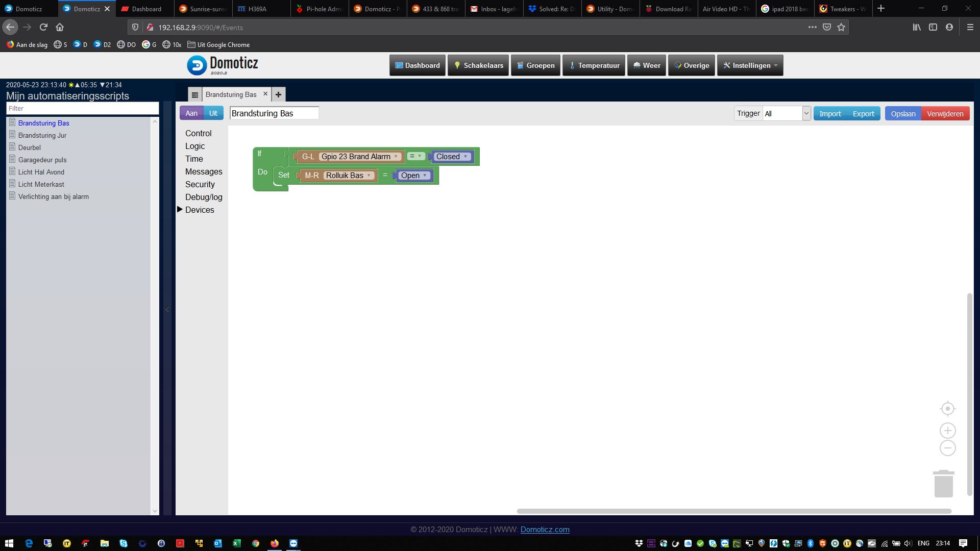

I have a question about a script that does work but does not have provide the right solution.
If my gpio contact goes closed it must send the blinds to an open position.
It does move the blinds but it sends them to the position of middle button if i would push my somfy remote.
I need the blinds to go up.
If my alarm system detects fire it will activate gpio and the script needs to open the blinds.
I am open to suggestions.
Thanks in advanced.

- Automation.jpg (143.28 KiB) Viewed 841 times

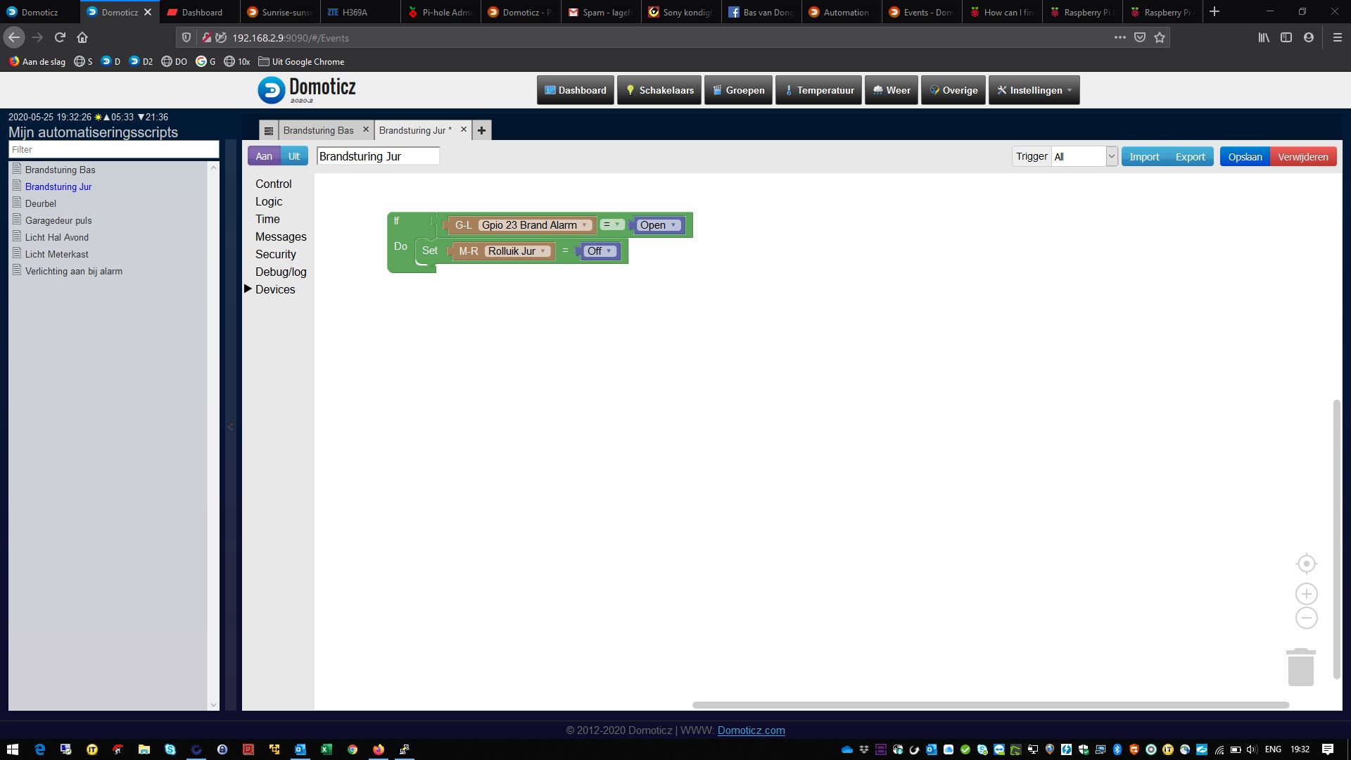

Ok boys,
I fixed it -->
My somfy had up down and favorite button.
Up is --> Off in the script
I fixed it -->
- domoticz.jpg (145.04 KiB) Viewed 808 times
