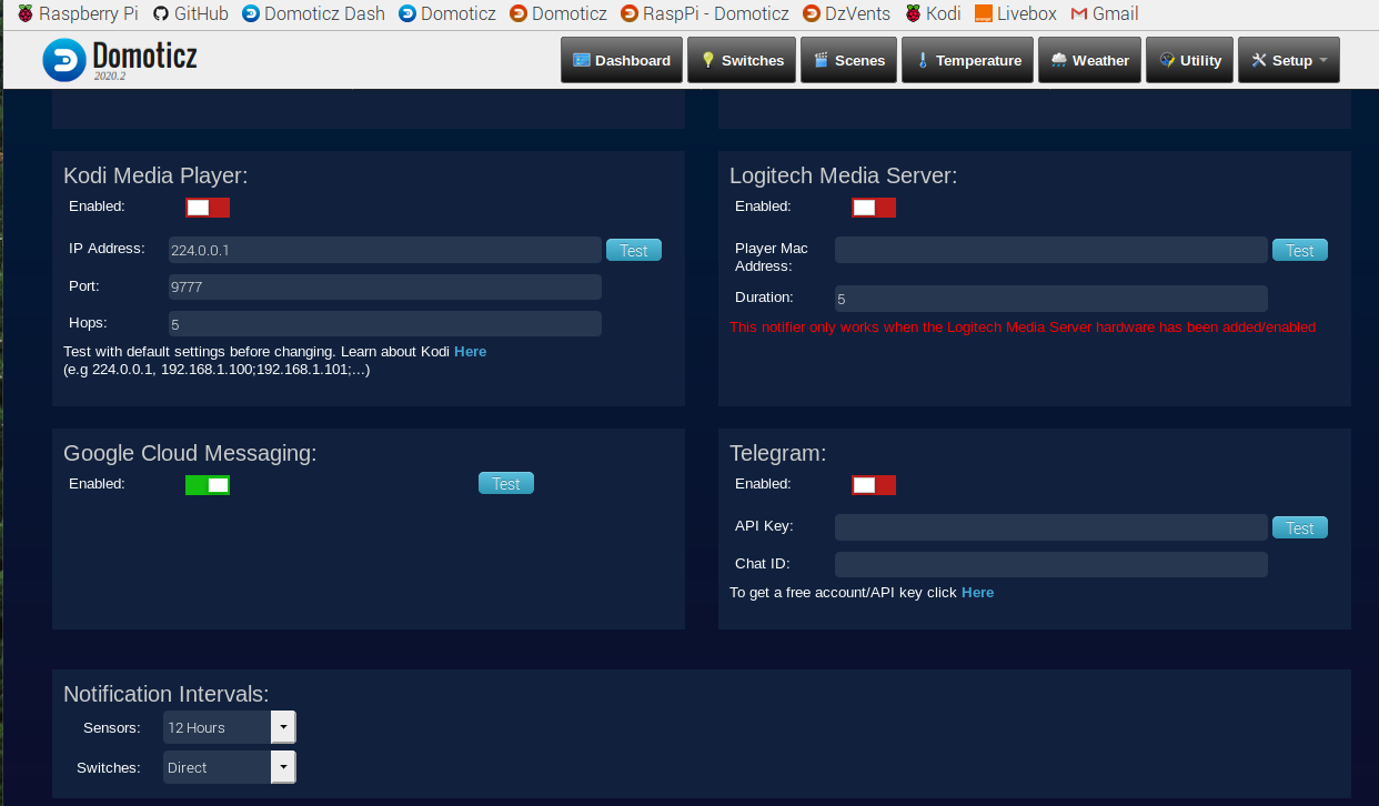

After some help and some tweaking please find a script which I made to both notify and adjust Fibaro Motion Sensor parameters when at home. These parameters are not accessible with standard dzVents commands. The idea is to save battery life. Furthermore, if you wish to use FCM (Firebase Cloud Messaging) please do not forget to enable GMC on the Setting; Notification page of your Domoticz Server.

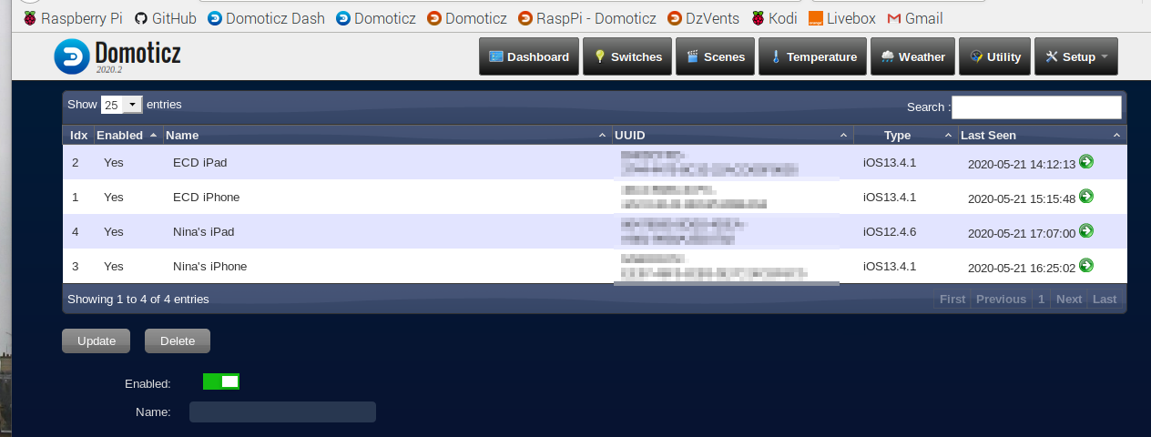

Your smartphone must also be registered in the Mobile Devices Setup page. I am using Domoticz on iOS. By no means, do I endorse it; however, it seems that if you wish to get notifications you must have the paid version. Toggle the notification switch in the iOS app to register your phone in Domoticz Server. It took some research to find this little trick.

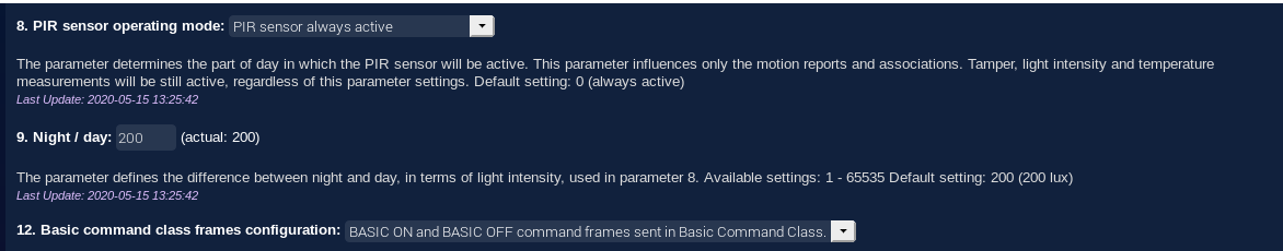

I am playing with the eighth and ninth parameters to "blind" devices when someone is at home. The script changes the eight parameter using a JSON command; Domoticz time and Security Panel Setting.
Please be aware that the device setting will be updated once the device wakes-up. In my particular case the Wake-up interval is 30 minutes. I will follow the battery life and find the compromise between a "blind" device and waking-up the device more often...
