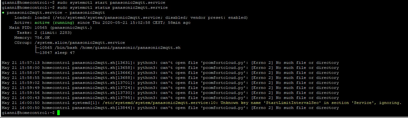

Hi, @Gianni,
Problems are there to solve them. :D
pcomfortcloud.py No such file or directory.
The panasonic2mqtt.sh file contains:
python3 pcomfortcloud.py login pasword get 1 | /<path_to_mosquitto_pub/mosquitto_pub --url mqtt://127.0.0.1 -t panasonic/living -l
It cannot find the path of pcomfortcloud.py and so we have to insert this.
So it will become:
/<path_to_python3/python3 pcomfortcloud.py login pasword get 1 | /<path_to_mosquitto_pub/mosquitto_pub --url mqtt://127.0.0.1 -t panasonic/living -s[/code]
/path_to_python3/python3 /home/gianni/panasonic/pcomfortcloud.py login pasword get 1 | /path_to_mosquitto_pub/mosquitto_pub --url mqtt://127.0.0.1/panasonic/living -l
You should check your path to python3 and insert it. Also the path for mosquitto_pub.
I have as a place holder inserted path_to_python3, resp path_to_mosquitto_pub
The unknown key name 'StartLimitIntervalSec' is obviously unknown in Ubuntu. You can delete it from the panasonic2mqtt.service file.
AdapterCommunicationerror is at the Panasonic side.
Do we request to often?
Do you use this adapter: http://www.panasonic.hk/usm.ashx/e/7zt1 ... maunal.pdf
If so, try to disconnect and start up again.
I hope you will manage to get the communication back.

i fixed the service
python3.8 /home/gianni/panasonic/pcomfortcloud.py login pasword get 1 | mosquitto_pub --url mqtt://127.0.0.1/panasonic/living -l;
Now it's running
It's looks like the script is runnnig fine and the problems were on the panasonic cloud site.
grts Gianni

@Gianni,
Fortunately the system is running. I was convinced that it could not be caused by the script, unless the Pansonic does not like to be queried every minute.
After youy closed the process with CTRL-C, I assume, the process could not be started again.
The reason was that the directory, where the pcomfortcloud.py has been installed in the directory /home/gianni/panasonic.
This directory is not in your path and therefore you have to use the full path, as I wrote.
The reason that it worked before was, that the process was started from /home/gianni/panasonic with the command ./panasonic2mqtt.sh
As I did not know where the python3 and mosquitto_pub have been installed, I suggested therefore also to use the full path, but obviously they are in the path. So a modification is not necessary.
So may we conclude that the service is running? Including start/stop? And is enabled so that we a publish (for the moment) every minute?

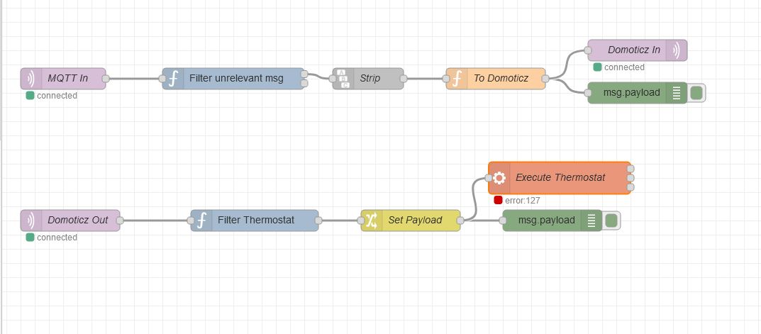

HI,
@Gianni,
If the panasonic2mqtt runs fine as a service we can leave that part and concentrate on Node Red.
Can you try this flow:
[{"id":"895546b7.2d10c","type":"mqtt in","z":"5bae5c9d.cc469c","name":"MQTT In","topic":"panasonic/#","qos":"2","datatype":"auto","broker":"c2d9657a.d81bf8","x":160,"y":320,"wires":[["969fd0fc.91ae2"]]},{"id":"ccb5a50f.4461e8","type":"string","z":"5bae5c9d.cc469c","name":"Strip","methods":[{"name":"strip","params":[{"type":"str","value":" "}]},{"name":"split","params":[{"type":"str","value":":"},{"type":"num","value":"2"}]}],"prop":"payload","propout":"payload","object":"msg","objectout":"msg","x":590,"y":320,"wires":[["7f7c8cad.7614fc"]]},{"id":"7f7c8cad.7614fc","type":"function","z":"5bae5c9d.cc469c","name":"To Domoticz","func":"if (msg.topic == \"panasonic/living\"){ \n\nswitch (msg.payload[0]) {\n\n    case \"temperatureInside\":\n    msg.payload = {\"command\":\"udevice\",\"idx\":8,\"nvalue\":0,\"svalue\":msg.payload[1]};\n    break;\n    \n    case \"temperatureOutside\":\n    msg.payload = {\"command\":\"udevice\",\"idx\":9,\"nvalue\":0,\"svalue\":msg.payload[1]};\n    break;  \n    \n    case \"temperature\":\n    msg.payload = {\"command\":\"udevice\",\"idx\":10,\"nvalue\":0,\"svalue\":msg.payload[1]};\n    break;\n}\n}\n\nif (msg.topic == \"panasonic/slaapkamer\"){ \n\nswitch (msg.payload[0]) {\n\n    case \"temperatureInside\":\n    msg.payload = {\"command\":\"udevice\",\"idx\":18,\"nvalue\":0,\"svalue\":msg.payload[1]};\n    break;\n    \n    case \"temperatureOutside\":\n    msg.payload = {\"command\":\"udevice\",\"idx\":19,\"nvalue\":0,\"svalue\":msg.payload[1]};\n    break;  \n    \n    case \"temperature\":\n    msg.payload = {\"command\":\"udevice\",\"idx\":20,\"nvalue\":0,\"svalue\":msg.payload[1]};\n    break;\n}\n}\n\nreturn msg;","outputs":1,"noerr":0,"x":770,"y":320,"wires":[["9fb89083.61ba9","44626582.97812c"]]},{"id":"9fb89083.61ba9","type":"debug","z":"5bae5c9d.cc469c","name":"","active":true,"tosidebar":true,"console":false,"tostatus":false,"complete":"false","x":970,"y":340,"wires":[]},{"id":"44626582.97812c","type":"mqtt out","z":"5bae5c9d.cc469c","name":"Domoticz In","topic":"domoticz/in","qos":"0","retain":"false","broker":"c2d9657a.d81bf8","x":970,"y":280,"wires":[]},{"id":"969fd0fc.91ae2","type":"filter","z":"5bae5c9d.cc469c","name":"Filter unrelevant msg","property":"payload","propertyType":"msg","asArray":false,"itemProperty":"","itemPropertyType":"item","rules":[{"t":"cont","v":"readingfromdevice","vt":"str","output":2},{"t":"eq","v":"id","vt":"str","output":2},{"t":"cont","v":"parameters","vt":"str","output":2},{"t":"else","output":1}],"checkall":"true","outputs":2,"x":400,"y":320,"wires":[["ccb5a50f.4461e8"],[]]},{"id":"c2d9657a.d81bf8","type":"mqtt-broker","z":"","name":"","broker":"127.0.0.1","port":"1883","clientid":"","usetls":false,"verifyservercert":true,"compatmode":true,"keepalive":"60","cleansession":true,"birthTopic":"","birthQos":"0","birthPayload":"","closeTopic":"","closePayload":"","willTopic":"","willQos":"0","willPayload":""}]
Open the function node and adjust the IDX for yours and what you want to test.
As said I have (as a test) created 3 device for TemperatureInside, TemperatureOutside and Temperature setting.
This are 2 virtual Temperature sensors and 1 thermostat setpoint.
I have now created 6 sensors, 3 for the living and 3 for the slaapkamer.
Test it
I assume that the TemperatureOutside for both are identical, so maybe one outside temperature sensor is enough.
Awaiting the result.

Good evening @Gianni,
I have been working at your flow.

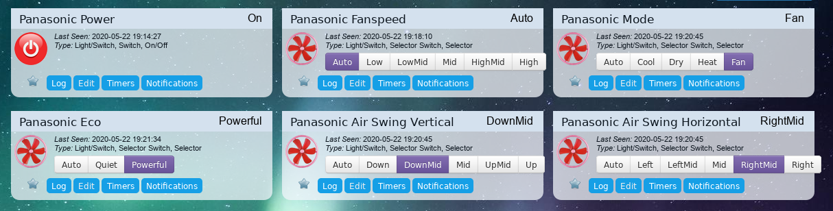

I think, you should (or maybe you did already) create the following virtual sensors. (This is for the "Living")
1. Temperature sensor: for Temperature Inside will appear under Temperature tab
2. Temperature sensor: for Temperature Outside will appear under Temperature tab
3. Thermostat Setpoint: for Temperature will appear under Utility tab
4. Switch: for Power will appear under Switches tab
5. Selector Switch: for Fanspeed will appear under Switches tab
6. Selector Switch: for Mode will appear under Switches tab
7. Selector Switch: for Eco will appear under Switches tab
8. Selector Switch: for Air swing Vertical will appear under Switches tab
9. Selector Switch: for Air Swing Horizontal will appear under Switches tab
The Selector Switches you have to edit, so click "Edit" for each Selector Switch and fill in the various items.
If you are finished, it should look like (but they are grey):
Note down all your IDX numbers!!!
Repeat this for your "slaapkamer". Do it also for the Outside temperature.
You can later configure it as "unused".
If you have finished the previous thing, copy the flow below to your Node Red.
And open the function node, called "To Domoticz" and adjust the IDX's according to your Domoticz configuration.
[{"id":"895546b7.2d10c","type":"mqtt in","z":"5bae5c9d.cc469c","name":"MQTT In","topic":"panasonic/#","qos":"2","datatype":"auto","broker":"c2d9657a.d81bf8","x":160,"y":539,"wires":[["969fd0fc.91ae2"]]},{"id":"ccb5a50f.4461e8","type":"string","z":"5bae5c9d.cc469c","name":"Strip","methods":[{"name":"strip","params":[{"type":"str","value":" "}]},{"name":"split","params":[{"type":"str","value":":"},{"type":"num","value":"2"}]}],"prop":"payload","propout":"payload","object":"msg","objectout":"msg","x":590,"y":539,"wires":[["7f7c8cad.7614fc"]]},{"id":"7f7c8cad.7614fc","type":"function","z":"5bae5c9d.cc469c","name":"To Domoticz","func":"if (msg.topic == \"panasonic/living\"){ \n\nswitch (msg.payload[0]) {\n\n    case \"temperatureInside\":\n    msg.payload = {\"command\":\"udevice\",\"idx\":8,\"nvalue\":0,\"svalue\":msg.payload[1]};\n    break;\n    \n    case \"temperatureOutside\":\n    msg.payload = {\"command\":\"udevice\",\"idx\":9,\"nvalue\":0,\"svalue\":msg.payload[1]};\n    break;  \n    \n    case \"temperature\":\n    msg.payload = {\"command\":\"udevice\",\"idx\":10,\"nvalue\":0,\"svalue\":msg.payload[1]};\n    break;\n    \n    case \"power\":\n    msg.payload = {\"command\":\"switchlight\", \"idx\": 11, \"switchcmd\": msg.payload[1]};\n    break;\n    \n    case \"fanSpeed\":\n\n        switch (msg.payload[1]) {\n            \n            case \"Auto\":\n            msg.payload = {\"command\":\"udevice\",\"idx\":12,\"nvalue\":1,\"svalue\":\"10\"};\n            break;\n            \n            case \"Low\":\n            msg.payload = {\"command\":\"udevice\",\"idx\":12,\"nvalue\":1,\"svalue\":\"20\"};\n            break;\n\n            case \"LowMid\":\n            msg.payload = {\"command\":\"udevice\",\"idx\":12,\"nvalue\":1,\"svalue\":\"30\"};\n            break;\n\n            case \"Mid\":\n            msg.payload = {\"command\":\"udevice\",\"idx\":12,\"nvalue\":1,\"svalue\":\"40\"};\n            break;\n            \n            case \"HighMid\":\n            msg.payload = {\"command\":\"udevice\",\"idx\":12,\"nvalue\":1,\"svalue\":\"50\"};\n            break;\n\n            case \"High\":\n            msg.payload = {\"command\":\"udevice\",\"idx\":12,\"nvalue\":1,\"svalue\":\"60\"};\n            break;\n\n        }\n    break;\n    \n    case \"mode\":\n        \n        switch (msg.payload[1]) {\n            \n            case \"Auto\":\n            msg.payload = {\"command\":\"udevice\",\"idx\":13,\"nvalue\":1,\"svalue\":\"10\"};\n            break;\n            \n            case \"Cool\":\n            msg.payload = {\"command\":\"udevice\",\"idx\":13,\"nvalue\":1,\"svalue\":\"20\"};\n            break;\n\n            case \"Dry\":\n            msg.payload = {\"command\":\"udevice\",\"idx\":13,\"nvalue\":1,\"svalue\":\"30\"};\n            break;\n\n            case \"Heat\":\n            msg.payload = {\"command\":\"udevice\",\"idx\":13,\"nvalue\":1,\"svalue\":\"40\"};\n            break;\n            \n            case \"Fan\":\n            msg.payload = {\"command\":\"udevice\",\"idx\":13,\"nvalue\":1,\"svalue\":\"50\"};\n            break;\n\n        }\n    break;\n    \n    case \"eco\":\n        \n        switch (msg.payload[1]) {\n    \n            case \"Auto\":\n            msg.payload = {\"command\":\"udevice\",\"idx\":14,\"nvalue\":1,\"svalue\":\"10\"};\n            break;\n            \n            case \"Quiet\":\n            msg.payload = {\"command\":\"udevice\",\"idx\":14,\"nvalue\":1,\"svalue\":\"20\"};\n            break;\n\n            case \"Powerful\":\n            msg.payload = {\"command\":\"udevice\",\"idx\":14,\"nvalue\":1,\"svalue\":\"30\"};\n            break;\n            \n        }\n    break;\n    \n    case \"airSwingVertical\":\n        \n        switch (msg.payload[1]) {\n\n            case \"Auto\":\n            msg.payload = {\"command\":\"udevice\",\"idx\":15,\"nvalue\":1,\"svalue\":\"10\"};\n            break;\n            \n            case \"Down\":\n            msg.payload = {\"command\":\"udevice\",\"idx\":15,\"nvalue\":1,\"svalue\":\"20\"};\n            break;\n\n            case \"DownMid\":\n            msg.payload = {\"command\":\"udevice\",\"idx\":15,\"nvalue\":1,\"svalue\":\"30\"};\n            break;\n\n            case \"Mid\":\n            msg.payload = {\"command\":\"udevice\",\"idx\":15,\"nvalue\":1,\"svalue\":\"40\"};\n            break;\n            \n            case \"UpMid\":\n            msg.payload = {\"command\":\"udevice\",\"idx\":15,\"nvalue\":1,\"svalue\":\"50\"};\n            break;\n\n            case \"Up\":\n            msg.payload = {\"command\":\"udevice\",\"idx\":15,\"nvalue\":1,\"svalue\":\"60\"};\n            break;\n\n        }\n    break;\n    \n    case \"airSwingHorizontal\":\n        \n        switch (msg.payload[1]) {\n\n            \n            case \"Auto\":\n            msg.payload = {\"command\":\"udevice\",\"idx\":16,\"nvalue\":1,\"svalue\":\"10\"};\n            break;\n            \n            case \"Left\":\n            msg.payload = {\"command\":\"udevice\",\"idx\":16,\"nvalue\":1,\"svalue\":\"20\"};\n            break;\n\n            case \"LeftMid\":\n            msg.payload = {\"command\":\"udevice\",\"idx\":16,\"nvalue\":1,\"svalue\":\"30\"};\n            break;\n\n            case \"Mid\":\n            msg.payload = {\"command\":\"udevice\",\"idx\":16,\"nvalue\":1,\"svalue\":\"40\"};\n            break;\n            \n            case \"RightMid\":\n            msg.payload = {\"command\":\"udevice\",\"idx\":16,\"nvalue\":1,\"svalue\":\"50\"};\n            break;\n\n            case \"Right\":\n            msg.payload = {\"command\":\"udevice\",\"idx\":16,\"nvalue\":1,\"svalue\":\"60\"};\n            break;\n\n        }\n    break;\n    \n}\n}\n\nif (msg.topic == \"panasonic/slaapkamer\"){ \n\nswitch (msg.payload[0]) {\n\n    case \"temperatureInside\":\n    msg.payload = {\"command\":\"udevice\",\"idx\":8,\"nvalue\":0,\"svalue\":msg.payload[1]};\n    break;\n    \n    case \"temperatureOutside\":\n    msg.payload = {\"command\":\"udevice\",\"idx\":9,\"nvalue\":0,\"svalue\":msg.payload[1]};\n    break;  \n    \n    case \"temperature\":\n    msg.payload = {\"command\":\"udevice\",\"idx\":10,\"nvalue\":0,\"svalue\":msg.payload[1]};\n    break;\n    \n    case \"power\":\n    msg.payload = {\"command\":\"switchlight\", \"idx\": 11, \"switchcmd\": msg.payload[1]};\n    break;\n    \n    case \"fanSpeed\":\n\n        switch (msg.payload[1]) {\n            \n            case \"Auto\":\n            msg.payload = {\"command\":\"udevice\",\"idx\":12,\"nvalue\":1,\"svalue\":\"10\"};\n            break;\n            \n            case \"Low\":\n            msg.payload = {\"command\":\"udevice\",\"idx\":12,\"nvalue\":1,\"svalue\":\"20\"};\n            break;\n\n            case \"LowMid\":\n            msg.payload = {\"command\":\"udevice\",\"idx\":12,\"nvalue\":1,\"svalue\":\"30\"};\n            break;\n\n            case \"Mid\":\n            msg.payload = {\"command\":\"udevice\",\"idx\":12,\"nvalue\":1,\"svalue\":\"40\"};\n            break;\n            \n            case \"HighMid\":\n            msg.payload = {\"command\":\"udevice\",\"idx\":12,\"nvalue\":1,\"svalue\":\"50\"};\n            break;\n\n            case \"High\":\n            msg.payload = {\"command\":\"udevice\",\"idx\":12,\"nvalue\":1,\"svalue\":\"60\"};\n            break;\n\n        }\n    break;\n    \n    case \"mode\":\n        \n        switch (msg.payload[1]) {\n            \n            case \"Auto\":\n            msg.payload = {\"command\":\"udevice\",\"idx\":13,\"nvalue\":1,\"svalue\":\"10\"};\n            break;\n            \n            case \"Cool\":\n            msg.payload = {\"command\":\"udevice\",\"idx\":13,\"nvalue\":1,\"svalue\":\"20\"};\n            break;\n\n            case \"Dry\":\n            msg.payload = {\"command\":\"udevice\",\"idx\":13,\"nvalue\":1,\"svalue\":\"30\"};\n            break;\n\n            case \"Heat\":\n            msg.payload = {\"command\":\"udevice\",\"idx\":13,\"nvalue\":1,\"svalue\":\"40\"};\n            break;\n            \n            case \"Fan\":\n            msg.payload = {\"command\":\"udevice\",\"idx\":13,\"nvalue\":1,\"svalue\":\"50\"};\n            break;\n\n        }\n    break;\n    \n    case \"eco\":\n        \n        switch (msg.payload[1]) {\n    \n            case \"Auto\":\n            msg.payload = {\"command\":\"udevice\",\"idx\":14,\"nvalue\":1,\"svalue\":\"10\"};\n            break;\n            \n            case \"Quiet\":\n            msg.payload = {\"command\":\"udevice\",\"idx\":14,\"nvalue\":1,\"svalue\":\"20\"};\n            break;\n\n            case \"Powerful\":\n            msg.payload = {\"command\":\"udevice\",\"idx\":14,\"nvalue\":1,\"svalue\":\"30\"};\n            break;\n            \n        }\n    break;\n    \n    case \"airSwingVertical\":\n        \n        switch (msg.payload[1]) {\n\n            case \"Auto\":\n            msg.payload = {\"command\":\"udevice\",\"idx\":15,\"nvalue\":1,\"svalue\":\"10\"};\n            break;\n            \n            case \"Down\":\n            msg.payload = {\"command\":\"udevice\",\"idx\":15,\"nvalue\":1,\"svalue\":\"20\"};\n            break;\n\n            case \"DownMid\":\n            msg.payload = {\"command\":\"udevice\",\"idx\":15,\"nvalue\":1,\"svalue\":\"30\"};\n            break;\n\n            case \"Mid\":\n            msg.payload = {\"command\":\"udevice\",\"idx\":15,\"nvalue\":1,\"svalue\":\"40\"};\n            break;\n            \n            case \"UpMid\":\n            msg.payload = {\"command\":\"udevice\",\"idx\":15,\"nvalue\":1,\"svalue\":\"50\"};\n            break;\n\n            case \"Up\":\n            msg.payload = {\"command\":\"udevice\",\"idx\":15,\"nvalue\":1,\"svalue\":\"60\"};\n            break;\n\n        }\n    break;\n    \n    case \"airSwingHorizontal\":\n        \n        switch (msg.payload[1]) {\n\n            \n            case \"Auto\":\n            msg.payload = {\"command\":\"udevice\",\"idx\":16,\"nvalue\":1,\"svalue\":\"10\"};\n            break;\n            \n            case \"Left\":\n            msg.payload = {\"command\":\"udevice\",\"idx\":16,\"nvalue\":1,\"svalue\":\"20\"};\n            break;\n\n            case \"LeftMid\":\n            msg.payload = {\"command\":\"udevice\",\"idx\":16,\"nvalue\":1,\"svalue\":\"30\"};\n            break;\n\n            case \"Mid\":\n            msg.payload = {\"command\":\"udevice\",\"idx\":16,\"nvalue\":1,\"svalue\":\"40\"};\n            break;\n            \n            case \"RightMid\":\n            msg.payload = {\"command\":\"udevice\",\"idx\":16,\"nvalue\":1,\"svalue\":\"50\"};\n            break;\n\n            case \"Right\":\n            msg.payload = {\"command\":\"udevice\",\"idx\":16,\"nvalue\":1,\"svalue\":\"60\"};\n            break;\n\n        }\n    break;\n    \n}\n}\n\nreturn msg;","outputs":1,"noerr":0,"x":770,"y":539,"wires":[["9fb89083.61ba9","44626582.97812c"]]},{"id":"9fb89083.61ba9","type":"debug","z":"5bae5c9d.cc469c","name":"","active":true,"tosidebar":true,"console":false,"tostatus":false,"complete":"false","x":970,"y":559,"wires":[]},{"id":"44626582.97812c","type":"mqtt out","z":"5bae5c9d.cc469c","name":"Domoticz In","topic":"domoticz/in","qos":"0","retain":"false","broker":"c2d9657a.d81bf8","x":970,"y":499,"wires":[]},{"id":"969fd0fc.91ae2","type":"filter","z":"5bae5c9d.cc469c","name":"Filter unrelevant msg","property":"payload","propertyType":"msg","asArray":false,"itemProperty":"","itemPropertyType":"item","rules":[{"t":"cont","v":"readingfromdevice","vt":"str","output":2},{"t":"eq","v":"id","vt":"str","output":2},{"t":"cont","v":"parameters","vt":"str","output":2},{"t":"else","output":1}],"checkall":"true","outputs":2,"x":400,"y":539,"wires":[["ccb5a50f.4461e8"],[]]},{"id":"c2d9657a.d81bf8","type":"mqtt-broker","z":"","name":"","broker":"127.0.0.1","port":"1883","clientid":"","usetls":false,"verifyservercert":true,"compatmode":true,"keepalive":"60","cleansession":true,"birthTopic":"","birthQos":"0","birthPayload":"","closeTopic":"","closePayload":"","willTopic":"","willQos":"0","willPayload":""}]
Now it is time to test and test and test, but remember this flow is ONLY the data from the pcomfortcloud.py script to Domoticz.
Actions, which will control your airco will follow if you have confirmed that it works as expected.
If you want things changed, you can try, but please report back.

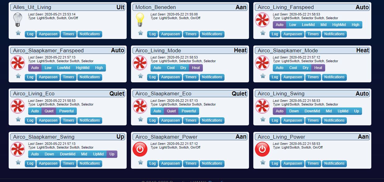

Gianni
Posts: 230
Joined: Saturday 21 July 2018 19:03
Location: Home@Belgium
Re: help with panasonic cloud
Post by Gianni »
Good evening FireWizard
I configured everything like you asked me.
Everything works except its just 1 step wrong.
I will try to explain with the eco mode

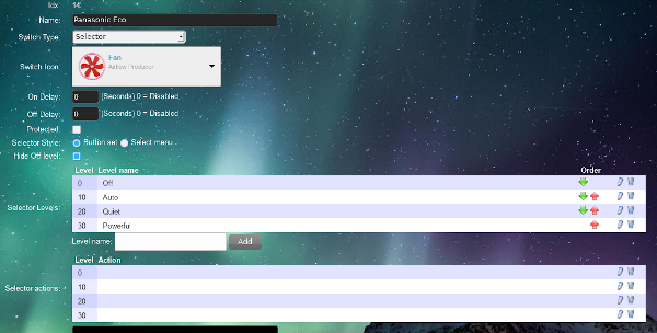

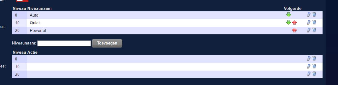

I have to change the Svalue from script in node red to
    case "eco":
            case "Auto":
            msg.payload = {"command":"udevice","idx":161,"nvalue":1,"svalue":"0"};
            break;
            case "Quiet":
            msg.payload = {"command":"udevice","idx":161,"nvalue":1,"svalue":"10"};
            break;
            case "Powerful":
            msg.payload = {"command":"udevice","idx":161,"nvalue":1,"svalue":"20"};
            break;
Because if i set it like 10/20/30 then the auto function show as Quiet, quiet as powerful and powerfull like undefined.
This is the same for all selectors.
If i change them to 0/10/20 in the script then the gui is correct in domoticz
Mvg Gianni

Gianni
Posts: 230
Post by Gianni »
ok then this is my fault
Bacause there is no off on the selectors i started auto with 0
Now i changed all the values on the node started with 0 and now all the selectors are correct.
the script is like this now

and the output on node red is this
22-5-2020 21:58:53node: 9828f9d.483f388
panasonic/living : msg.payload : array[1]
[ "readingfromdevice'Living'(d4f0…" ]
22-5-2020 21:58:54node: 9828f9d.483f388panasonic/living : msg.payload : array[2]
[ "id", "d4f027aa88086920e86a5b7cb84631…" ]
22-5-2020 21:58:55node: 9828f9d.483f388panasonic/living : msg.payload : Object
{ command: "udevice", idx: 138, nvalue: 0, svalue: "23" }
22-5-2020 21:58:56node: 9828f9d.483f388panasonic/living : msg.payload : Object
{ command: "udevice", idx: 137, nvalue: 0, svalue: "16" }
22-5-2020 21:58:57node: 9828f9d.483f388panasonic/living : msg.payload : Object
{ command: "udevice", idx: 139, nvalue: 0, svalue: "25.5" }
22-5-2020 21:58:58node: 9828f9d.483f388panasonic/living : msg.payload : Object
{ command: "switchlight", idx: 140, switchcmd: "On" }
22-5-2020 21:58:59node: 9828f9d.483f388panasonic/living : msg.payload : Object
{ command: "udevice", idx: 159, nvalue: 1, svalue: "30" }
22-5-2020 21:59:00node: 9828f9d.483f388panasonic/living : msg.payload : Object
{ command: "udevice", idx: 157, nvalue: 1, svalue: "0" }
22-5-2020 21:59:01node: 9828f9d.483f388panasonic/living : msg.payload : array[2]
[ "airSwingHorizontal", "Auto" ]
22-5-2020 21:59:02node: 9828f9d.483f388panasonic/living : msg.payload : Object
{ command: "udevice", idx: 163, nvalue: 1, svalue: "0" }
22-5-2020 21:59:03node: 9828f9d.483f388panasonic/living : msg.payload : Object
{ command: "udevice", idx: 161, nvalue: 1, svalue: "10" }
22-5-2020 21:59:10node: 9828f9d.483f388panasonic/slaapkamer : msg.payload : array[1]
[ "readingfromdevice'Slaapkamer'(…" ]
22-5-2020 21:59:11node: 9828f9d.483f388panasonic/slaapkamer : msg.payload : array[2]
[ "{'message'", "'Tokenexpires','code'" ]
22-5-2020 22:00:51node: 9828f9d.483f388panasonic/living : msg.payload : array[1]
22-5-2020 22:00:51node: 9828f9d.483f388panasonic/living : msg.payload : array[2]
22-5-2020 22:00:51node: 9828f9d.483f388panasonic/living : msg.payload : Object
22-5-2020 22:01:09node: 9828f9d.483f388panasonic/slaapkamer : msg.payload : array[1]
22-5-2020 22:01:10node: 9828f9d.483f388panasonic/slaapkamer : msg.payload : array[2]
[ "id", "e5b4c4979fda3a3ccc56e186b7b05e…" ]
22-5-2020 22:01:11node: 9828f9d.483f388panasonic/slaapkamer : msg.payload : Object
{ command: "udevice", idx: 141, nvalue: 0, svalue: "26" }
22-5-2020 22:01:12node: 9828f9d.483f388panasonic/slaapkamer : msg.payload : Object
{ command: "udevice", idx: 165, nvalue: 0, svalue: "16" }
22-5-2020 22:01:13node: 9828f9d.483f388panasonic/slaapkamer : msg.payload : Object
{ command: "udevice", idx: 142, nvalue: 0, svalue: "23.0" }
22-5-2020 22:01:14node: 9828f9d.483f388panasonic/slaapkamer : msg.payload : Object
{ command: "switchlight", idx: 166, switchcmd: "On" }
22-5-2020 22:01:15node: 9828f9d.483f388panasonic/slaapkamer : msg.payload : Object
{ command: "udevice", idx: 160, nvalue: 1, svalue: "30" }
22-5-2020 22:01:16node: 9828f9d.483f388panasonic/slaapkamer : msg.payload : Object
{ command: "udevice", idx: 158, nvalue: 1, svalue: "0" }
22-5-2020 22:01:17node: 9828f9d.483f388panasonic/slaapkamer : msg.payload : array[2]
22-5-2020 22:01:18node: 9828f9d.483f388panasonic/slaapkamer : msg.payload : Object
{ command: "udevice", idx: 164, nvalue: 1, svalue: "50" }
22-5-2020 22:01:19node: 9828f9d.483f388panasonic/slaapkamer : msg.payload : Object
{ command: "udevice", idx: 162, nvalue: 1, svalue: "10" }

Find below a flow to control the thermostat.
It is only for he Living (I think)
You can copy it to same page. It does not replace the other.
[{"id":"a55d1886.0b0e68","type":"debug","z":"5bae5c9d.cc469c","name":"","active":true,"tosidebar":true,"console":false,"tostatus":false,"complete":"false","x":790,"y":820,"wires":[]},{"id":"cd5824d5.88c28","type":"mqtt in","z":"5bae5c9d.cc469c","name":"Domoticz Out","topic":"domoticz/out","qos":"2","datatype":"json","broker":"c2d9657a.d81bf8","x":150,"y":820,"wires":[["c939d06.df4863"]]},{"id":"c939d06.df4863","type":"filter","z":"5bae5c9d.cc469c","name":"Filter Thermostat","property":"payload.idx","propertyType":"msg","asArray":false,"itemProperty":"","itemPropertyType":"item","rules":[{"t":"eq","v":"10","vt":"str","output":1}],"checkall":"true","outputs":1,"x":370,"y":820,"wires":[["a8b02665.ea42d"]]},{"id":"a8b02665.ea42d","type":"change","z":"5bae5c9d.cc469c","name":"Set Payload","rules":[{"t":"move","p":"payload.svalue1","pt":"msg","to":"payload","tot":"msg"}],"action":"","property":"","from":"","to":"","reg":false,"x":590,"y":820,"wires":[["a55d1886.0b0e68","b0b60272.1450d8"]]},{"id":"b0b60272.1450d8","type":"exec","z":"5bae5c9d.cc469c","command":"python3 /home/gianni/panasonic/pcomfortcloud.py login pasword set 1 -t ","addpay":true,"append":"","useSpawn":"false","timer":"","oldrc":false,"name":"Execute Thermostat","x":800,"y":760,"wires":[[],[],[]]},{"id":"c2d9657a.d81bf8","type":"mqtt-broker","z":"","name":"","broker":"127.0.0.1","port":"1883","clientid":"","usetls":false,"verifyservercert":true,"compatmode":true,"keepalive":"60","cleansession":true,"birthTopic":"","birthQos":"0","birthPayload":"","closeTopic":"","closePayload":"","willTopic":"","willQos":"0","willPayload":""}]
Probably you have to install the Filter node, as you did before.
Do not forget to change the IDX in the Filter node!

in the excecute node i added the pasword and login into the command but where do is change the idx in the filter node?
grts Gianni
FireWizard
Posts: 1979
Location: Voorthuizen (NL)
Post by FireWizard »
@Gianni
If you open the Filter node, you see currently a 10. Change that to your Thermostat IDX.

changed the idx but get a error on node red when is changed the temp from within domoticz
and i filter only on the second flow ,you see i set the temp on 20° but after a while it's back to the original temp
grts Gianni

fixed the first error
python3/home/gianni/panasonic/pcomfortcloud.py login pasword set 1 -t
to python3 home/gianni/panasonic/pcomfort..................
but now i get a error code 2
FireWizard
Posts: 1979
@Gianni
I see that you had no space between python3/home/gianni................
You changed it but it should be:
python3 /home/gianni/panasonic/pcomfort.
instead of
A / before home.
Try it
Gianni
Posts: 230
Post by Gianni »
i see this message to late ;-)
I was starting to debug myself with node red and add a msg.payload after the execute and then i could see the error that the sript was not found.
I made indeed a mistake to remove the /home slash
NOw it s works :P :P
grts Gianni
