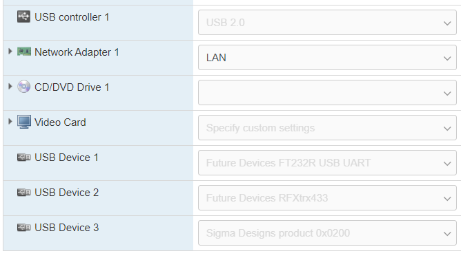

I run the free version. You don't need USB pass through, Just stick the USB sticks in the esxi server, just add a USB controller to the VM, and then add the USB devices that are plugged in into the server, they will be visible as a device. I have 3 USB device added, P1 Smart meter, RFXCom and a Zwave stick.
Aantekening 2020-05-23 104756.png (25.51 KiB) Viewed 1763 times

Very cool, thanks a lot, I never really looked into it.
my ESXI is the most reliable device I have, running for 5+ years now, 24/7.
I will check it out for sure :)
