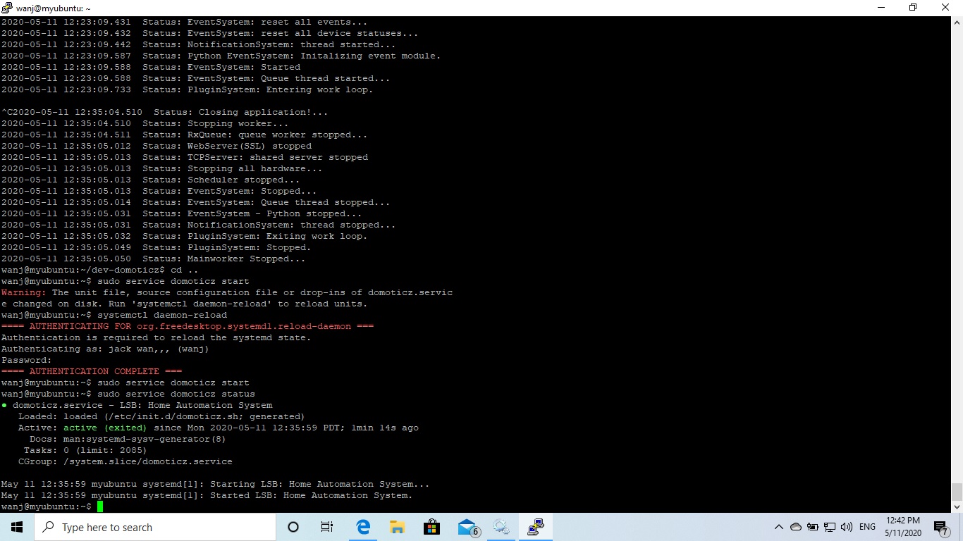

I followed the instruction in the wiki page to the letter and was able to "make" or build from source code, Except
in the last section, the instruction "cd domoticz" does not work, because there was nothing in that subdirectory, the current directory is /dev-domoticz
I was able to run sudo ./domoticz from the dev-domoticz and for 12 minutes, I was stuck in the plug-ins process, I cancel the entire process
and issue the command sudo service domoticz start. You can see in my attached screen shot
The problem now is when I web access my server (192.168.1.5:18088) I got "domoticz offline".
Should I go back to redo that sudo ./domoticz and wait it finish. I also saw that error message "no server is installed" perhaps that is the reason it is off line, what did I do wrong. In the domoticz.sh file I did change the www port to 18088 and input my id, that is all. How come ./domoticz did not find the ip address and port?

jackwan1 wrote: Monday 11 May 2020 22:09 Except in the last section, the instruction "cd domoticz" does not work, because there was nothing in that subdirectory, the current directory is /dev-domoticz
Can you please share the contents of /etc/init.d/domoticz.sh (between code tags please)
I think a step should be added in the build instructions and that is to copy from /dev-domoticz to the directory you are going to use for ' production'
You want to keep the production directory separated form your compile / development directory

jackwan1 wrote: Tuesday 12 May 2020 2:36 here you go
Can you change the DAEMON arg section with this snippet? It will start logging to /var/log/domoticz.log so you can see what happens
DAEMON=/home/$USERNAME/domoticz/$NAME
DAEMON_ARGS="-daemon"
DAEMON_ARGS="$DAEMON_ARGS -daemonname $NAME -pidfile $PIDFILE"
DAEMON_ARGS="$DAEMON_ARGS -www 18088"
DAEMON_ARGS="$DAEMON_ARGS -sslwww 443"
DAEMON_ARGS="$DAEMON_ARGS -log /var/log/domoticz.log"
DAEMON_ARGS="$DAEMON_ARGS -loglevel  normal,status,error"
#DAEMON_ARGS="$DAEMON_ARGS -syslog"

@waaren
U are absolutely correct. After I copied what you indicated below, domoticz started without any problem and I don't think the log is necessary. I can't edit the domoticz.sh file in the /etc/init.d/ anyway. right now the sh file in dev-domoticz has added log commands, but I don't think it is executed because there is no log files created in the directory. I still have few more questions.
1. right now should I start/stop domoticz using the sudo service domoticz start command or the sudo service domoticz.sh start command? I don't think I can do the sudo service domoticz start(or stop).
2. If I reboot the server, will domoticz load? I guess I should check it out.
3. Should I follow the wiki to set an auto update process using the git pull and make? If so, how often it will run, because I spent few hours to make this time, few months later, if the server is going to take hours to update, I or some one else might thought it is broken.

jackwan1 wrote: Tuesday 12 May 2020 20:59 I can't edit the domoticz.sh file in the /etc/init.d/ anyway.
If you copy the file from dev-domoticz/domoticz.sh to /etc/init.d/domoticz.sh you should be able to edit it
after editing
sudo systemctl daemon-reload
sudo update-rc.d domoticz.sh defaults  #  enable the automatic start of domoticz
sudo service domoticz stop
sudo service domoticz start # should work after you did the above actions
See above

@waaren
Ok. everything is working, including restore database and load domoticz on reboot. Thank you.
I tried to issue commands for updater described in the wiki. I have few problems
1. there is no monit in /etc/init.d/, perhaps it is an outdated reference not used today?
2. if I goto ~/domoticz and issue git pull, it will not execute because there is no repository
3. I have to goto ~/dev-domoticz to issue that git pull, but it will list a group of new files and asking for commit. I guess options -merge and -commit should be used for the git command
4. Even I can make the git pull, I guess I have to copy (rsync) from the dev subdirectory to domoticz subdirectory as you have posted before.
5. If I login as root and created the updater.sh in the root directory and sh it in the root directory, so sudo will not be used and password need not to be entered and I guess it will be installed as a corn job and will be processed every so often. of course, syntax must be correct first.
Not sure my above thinking is correct or not, nevertheless, if I am right, the wiki should be updated.
Re: update domoticz from 3.7 (2017 version)
jackwan1 wrote: Wednesday 13 May 2020 0:23 @waaren
monit is a separate tool; not directly related to domoticz. Did you do a sudo apt install monit?
you should do this while in domoticz-dev or the directory where all your sources are.
No a git pull should be enough. Can you try with a sudo git stash before the push? If no luck then please show what you see.
. Yes after the make you have to rsync again
Don't understand but guess this is not specific to domoticz but generic linux.
The wiki is for all of us and also from all of us. If you think it should be updated. Please send me a PM with an email address and preferred user-id and I wil creat an account for you so you can update the pages that are not complete yet.
