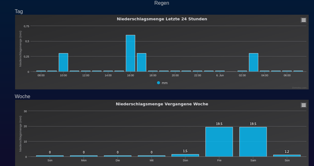

I noticed also negative amounts of rain. I didn't change the code since my last post. Without that negative amount watering wouldn't start! If there is no explanation for negative amounts Is there code to ignore negative amounts?
	"result" :
			"d" : "2021-06-05 08:00",
			"mm" : "0.0"
			"d" : "2021-06-05 09:00",
			"mm" : "0.0"
			"d" : "2021-06-05 10:00",
			"mm" : "0.3"
			"d" : "2021-06-05 11:00",
			"mm" : "0.0"
			"d" : "2021-06-05 12:00",
			"mm" : "0.0"
			"d" : "2021-06-05 13:00",
			"mm" : "0.0"
			"d" : "2021-06-05 14:00",
			"mm" : "0.0"
			"d" : "2021-06-05 15:00",
			"mm" : "0.0"
			"d" : "2021-06-05 16:00",
			"mm" : "0.6"
			"d" : "2021-06-05 17:00",
			"mm" : "0.3"
			"d" : "2021-06-05 18:00",
			"mm" : "0.0"
			"d" : "2021-06-05 19:00",
			"mm" : "0.0"
			"d" : "2021-06-05 20:00",
			"mm" : "0.0"
			"d" : "2021-06-05 21:00",
			"mm" : "0.0"
			"d" : "2021-06-05 22:00",
			"mm" : "0.0"
			"d" : "2021-06-05 23:00",
			"mm" : "0.0"
			"d" : "2021-06-06 00:00",
			"mm" : "0.0"
			"d" : "2021-06-06 01:00",
			"mm" : "-1.2"
			"d" : "2021-06-06 02:00",
			"mm" : "0.0"
			"d" : "2021-06-06 03:00",
			"mm" : "0.3"
			"d" : "2021-06-06 04:00",
			"mm" : "0.0"
			"d" : "2021-06-06 05:00",
			"mm" : "0.0"
			"d" : "2021-06-06 06:00",
			"mm" : "0.0"
			"d" : "2021-06-06 07:00",
			"mm" : "0.0"
	"status" : "OK",
	"title" : "Graph rain day"
Bildschirmfoto vom 2021-06-06 07-55-58.png (56.15 KiB) Viewed 9046 times

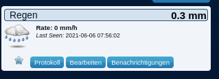

What amount of rain is showing on the device? The amount of last 24 hours or the last bigger than zero?
Bildschirmfoto vom 2021-06-06 07-56-45.png (11.22 KiB) Viewed 9046 times
Thanks for any help
