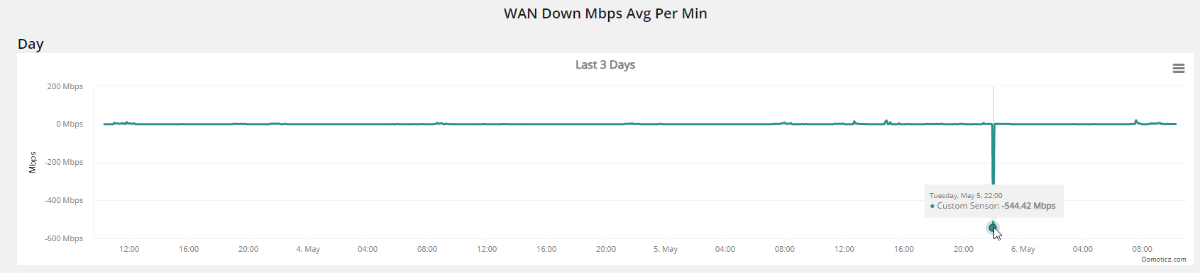

I installed the script but i'm experience a strange behavior.
Once a day (random time as far as i can tell) I get a negative measure for the "WAN Down Mbps Avg Per Min".
Does anybody experienced this behavior as well, and how did you fixed it (has it something to do with the router)?
I was thinking about an extra line of code to validate the result, if it is a negative number i will not update it to domoticz. But that is not really an fix more a workaround.
Domoticz:
Version: 2020.2
Build Hash: b63341bc0
Compile Date: 2020-04-26 13:47:55
dzVents Version: 3.0.2
Python Version: 3.7.3 (default, Dec 20 2019, 18:57:59) [GCC 8.3.0]
Router:
Router ModelTP-Link ARCHER-C5 v1
Firmware Version DD-WRT v3.0-r40559 std (08/06/19)
Kernel VersionLinux 3.18.140 #49336 Tue Aug 6 03:18:43 +04 2019 mips
