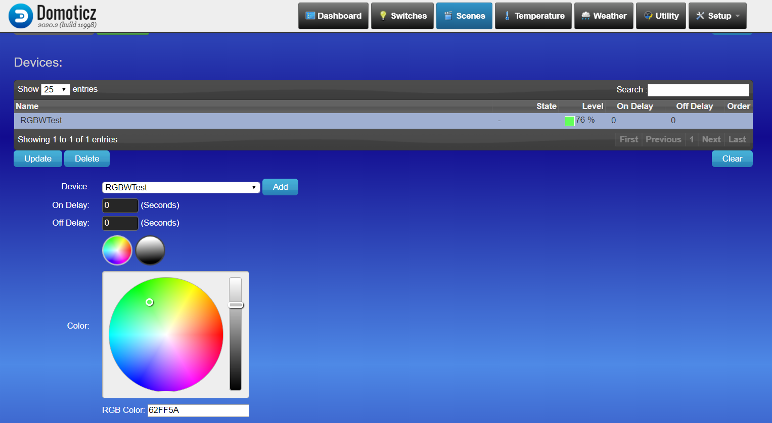

Maybe I miss something but would it not be much easier to just set the device color you want when adding the bulbs to the group ?

marktn wrote: Wednesday 29 April 2020 20:37.
It looks like you bulb is not defined as color device. If it isn't a color device, setting a color with dzVents or something else will not work either.

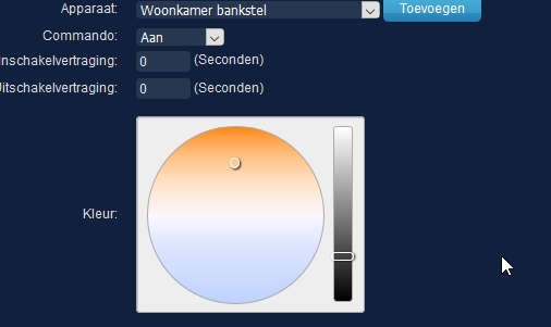

If you're using zigate then I advice you to create a group in zigate, you'll get a new widget for the group.
Are all your bulbs the same? The possibility of the group is based on the bulb with the least possibilities.

I see the difference, color lights RGB have a color code. The WW lights have no color code.
Copy/paste of the color is not possible for WW lights.
