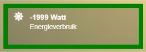

The previous example changes the icon and applies a custom css class ('deliver') in case you deliver power to the grid.
You can define the deliver css class in custom.css:
.mh.deliver {
    border-color: green
This will give a green border to the block.
Annotation 2020-04-21 101826.jpg (7.51 KiB) Viewed 799 times
