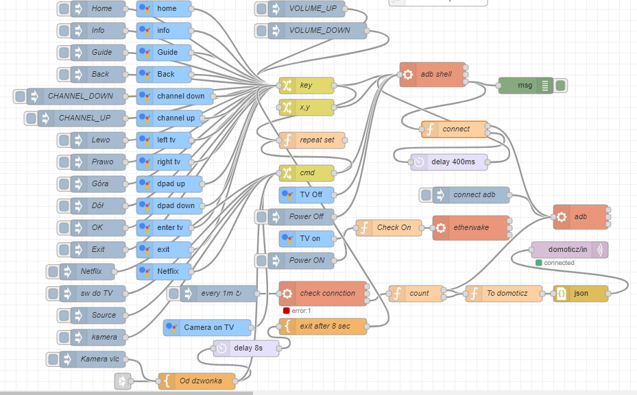

Hi.
I wanted to present my way of integrating Domoticz with Android TV.
I spent a lot of time looking for a solution and did not find it so I decided to create my own.
The only thing I found is a connection via adb shell to Android TV.
To make this possible, the TV programming options and USB debugging should be unlocked.
Usb debuging must be enabled in you want use adb through wireless or wired network connection.
If you want turn ON you should be use wired connection for WoL feature.
On TV you need confirm agreement when you connect with adb for first time.
Also you need to have node red, adb and etherwake installed on you server.
apt-get install adb etherwake
And these aplications must be in your PATH for exec node.
For info about node red installation you can go to domoticz wiki page.
I use Debian Buster on the X86 machine, but I think it should work on raspbinan as well.
I not use a Domoticz virtual switches for remote control, but is easy to implement.
I use nora with google home mini for it.
Using this flow I can renmote control Android TV and also start some apps as VLC with my camera when someone pushing doorbel button.
Obviously VLC must be installed on TV.
I use TCL 65EP640, but it should be work with other models too.
Of course you need adopt IP, streams settings etc. for your own conditions.
On comment node is plenty of useful links with knowledge how to use adb.

        "topic": "up",
        "onvalue": "\"KEYCODE_DPAD_UP\"",
        "onvalueType": "str",
        "offvalue": "false",
        "offvalueType": "bool",
        "x": 540,
        "y": 700,
        "wires": [
                "855186b6.e141b8"
        "id": "a98dcd2a.8ae0a",
        "type": "nora-scene",
        "z": "739eac25.dc37a4",
        "devicename": "dpad down",
        "roomhint": "",
        "scenereversible": false,
        "name": "",
        "nora": "4aa17da2.220c54",
        "topic": "down",
        "onvalue": "\"KEYCODE_DPAD_DOWN\"",
        "x": 540,
        "y": 740,
        "wires": [
                "855186b6.e141b8"
        "id": "d64d2028.10412",
        "devicename": "left tv",
        "roomhint": "",
        "name": "",
        "topic": "left",
        "onvalue": "\"KEYCODE_DPAD_LEFT\"",
        "x": 530,
        "y": 620,
        "wires": [
                "855186b6.e141b8"
        "id": "18b070cf.c893af",
        "devicename": "right tv",
        "roomhint": "",
        "name": "",
        "topic": "right",
        "onvalue": "\"KEYCODE_DPAD_RIGHT\"",
        "x": 530,
        "y": 660,
        "wires": [
                "855186b6.e141b8"
        "id": "dd438abd.bb02f8",
        "devicename": "home",
        "roomhint": "",
        "name": "",
        "topic": "",
        "onvalue": "3",
        "x": 530,
        "y": 380,
        "wires": [
                "855186b6.e141b8"
        "id": "d77601c1.15598",
        "devicename": "exit",
        "roomhint": "",
        "name": "",
        "topic": "",
        "onvalue": "4095",
        "x": 530,
        "y": 820,
        "wires": [
                "855186b6.e141b8"
        "id": "cdd34e7b.9dcb9",
        "type": "inject",
        "name": "kamera",
        "topic": "",
        "payload": "-a android.intent.action.VIEW -d -n com.rcreations.ipcamviewer/.WebCamViewerActivity",
        "payloadType": "str",
        "repeat": "",
        "crontab": "",
        "once": false,
        "onceDelay": 0.1,
        "x": 410,
        "y": 980,
        "wires": [
                "ac8f70dc.c1e88"
        "id": "7f150b3c.9eef84",
        "type": "inject",
        "name": "Home",
        "topic": "",
        "payload": "3",
        "repeat": "",
        "crontab": "",
        "once": false,
        "onceDelay": 0.1,
        "x": 410,
        "y": 380,
        "wires": [
                "855186b6.e141b8"
        "id": "6489fd28.d9d0c4",
        "type": "inject",
        "name": "Exit",
        "topic": "",
        "payload": "4095",
        "repeat": "",
        "crontab": "",
        "once": false,
        "onceDelay": 0.1,
        "x": 410,
        "y": 820,
        "wires": [
                "855186b6.e141b8"
        "id": "808d4c0c.23185",
        "type": "inject",
        "name": "Info",
        "topic": "",
        "payload": "165",
        "repeat": "",
        "crontab": "",
        "once": false,
        "onceDelay": 0.1,
        "x": 410,
        "y": 420,
        "wires": [
                "855186b6.e141b8"
        "id": "6cb823fc.feef1c",
        "type": "exec",
        "command": "lsof -i -P -n | grep 192.168.22.202:5555",
        "addpay": false,
        "append": "",
        "useSpawn": "false",
        "timer": "5",
        "oldrc": false,
        "name": "check connction",
        "x": 820,
        "y": 900,
        "wires": [
                "fd69e444.2fba38"
        "id": "d4de92dd.4affc",
        "type": "inject",
        "name": "every 1m",
        "topic": "",
        "payload": "",
        "payloadType": "date",
        "repeat": "60",
        "crontab": "",
        "once": true,
        "onceDelay": 0.1,
        "x": 630,
        "y": 900,
        "wires": [
                "6cb823fc.feef1c"
        "id": "fd69e444.2fba38",
        "type": "function",
        "name": "count",
        "func": "if ( msg.payload.code !== 0 )\n{\nmsg.payload = \" connect 192.168.22.202 | grep connected\";\nvar count = flow.get('count')||0;\ncount += 1;\n// store the value back\nflow.set('count',count);\n// make it part of the outgoing msg object\nmsg.count = count;\nreturn [msg,null];\n}\nelse {\ncount = 0;\nflow.set('count',count);\n// make it part of the outgoing msg object\nmsg.count = count;\nreturn [null,msg];\n}\n",
        "outputs": 2,
        "noerr": 0,
        "x": 990,
        "y": 900,
        "wires": [
                "88dfc0a8.adc25",
                "a2fd2a9f.68a5b8"
                "a2fd2a9f.68a5b8"
        "id": "14dbd174.07033f",
        "type": "function",
        "name": "repeat set",
        "func": "// Last command store for repat after connection error\n//var count = flow.get('count')||0;\n//if ( count !==0 ) {\n flow.set('repeat',msg.payload);   \n//}\nreturn msg;",
        "outputs": 1,
        "noerr": 0,
        "x": 800,
        "y": 620,
        "wires": [
        "id": "c164661e.44a3d8",
        "type": "delay",
        "name": "",
        "pauseType": "delay",
        "timeout": "400",
        "timeoutUnits": "milliseconds",
        "rate": "1",
        "nbRateUnits": "1",
        "rateUnits": "second",
        "randomFirst": "1",
        "randomLast": "5",
        "randomUnits": "seconds",
        "drop": false,
        "x": 1050,
        "y": 660,
        "wires": [
                "69d3ac6c.581094"
        "id": "8d07c0b9.ca068",
        "devicename": "TV Off",
        "roomhint": "",
        "name": "",
        "topic": "power",
        "onvalue": "\"KEYCODE_POWER\"",
        "x": 790,
        "y": 720,
        "wires": [
                "69d3ac6c.581094"
        "id": "3378b07b.4088",
        "type": "inject",
        "name": "Power Off",
        "topic": "",
        "payload": "KEYCODE_POWER",
        "repeat": "",
        "crontab": "",
        "once": false,
        "onceDelay": 0.1,
        "x": 780,
        "y": 760,
        "wires": [
                "69d3ac6c.581094"
        "id": "5b3675a0.13be6c",
        "type": "function",
        "name": "Check On",
        "func": "// checkin TV already ON\n// preventing unneeded Off\nvar count = flow.get('count')||0;\nif ( count !== 0 ) {\nreturn msg;\n}",
        "outputs": 1,
        "noerr": 0,
        "x": 940,
        "y": 780,
        "wires": [
                "107abe08.4f9132"
        "id": "7df11d30.c2ea14",
        "type": "inject",
        "name": "Source",
        "topic": "",
        "payload": "-a android.intent.action.VIEW -d -n com.tcl.sourcemananger/com.tcl.sourcemanager.MainActivity",
        "repeat": "",
        "crontab": "",
        "once": false,
        "onceDelay": 0.1,
        "x": 410,
        "y": 940,
        "wires": [
                "ac8f70dc.c1e88"
        "id": "a2fd2a9f.68a5b8",
        "type": "function",
        "name": "To domoticz",
        "func": "// domoticz TV status indicator\n// swithchtype contact\nmsg.payload = {};\n    msg.payload.command = \"switchlight\"\n    msg.payload.idx = 201;\n    //msg.payload.nvalue = 0;\nif ( msg.count === 0 ) {\n    \n    msg.payload.switchcmd = \"On\";   \n}\nelse {\n    msg.payload.switchcmd = \"Off\";\n}\nreturn msg;",
        "outputs": 1,
        "noerr": 0,
        "x": 1150,
        "y": 900,
        "wires": [
                "e7cc889.cb31478"
        "id": "1059f391.03785c",
        "type": "mqtt out",
        "name": "",
        "topic": "domoticz/in",
        "qos": "2",
        "retain": "false",
        "broker": "9748a36f.44bdd",
        "x": 1270,
        "y": 820,
        "wires": []
        "id": "e7cc889.cb31478",
        "type": "json",
        "name": "",
        "property": "payload",
        "action": "",
        "pretty": false,
        "x": 1290,
        "y": 900,
        "wires": [
                "1059f391.03785c"
        "id": "47ee0b65.567934",
        "type": "inject",
        "name": "Guide",
        "topic": "",
        "payload": "4001",
        "repeat": "",
        "crontab": "",
        "once": false,
        "onceDelay": 0.1,
        "x": 410,
        "y": 460,
        "wires": [
                "855186b6.e141b8"
        "id": "68a7a0f5.9ccbf",
        "type": "inject",
        "name": "Back",
        "topic": "",
        "payload": "4",
        "repeat": "",
        "crontab": "",
        "once": false,
        "onceDelay": 0.1,
        "x": 410,
        "y": 500,
        "wires": [
                "855186b6.e141b8"
        "id": "45164038.2ba51",
        "type": "inject",
        "name": "sw do TV",
        "topic": "",
        "payload": "-a android.intent.action.VIEW -d -n com.tcl.tv/.TVActivity",
        "repeat": "",
        "crontab": "",
        "once": false,
        "onceDelay": 0.1,
        "x": 400,
        "y": 900,
        "wires": [
                "ac8f70dc.c1e88"
        "id": "89264521.6ec2f8",
        "type": "delay",
        "name": "",
        "timeout": "8",
        "timeoutUnits": "seconds",
        "rate": "1",
        "nbRateUnits": "1",
        "randomFirst": "1",
        "randomLast": "5",
        "drop": false,
        "x": 680,
        "y": 1000,
        "wires": [
                "c1a5d4d0.e620f8"
        "id": "c1a5d4d0.e620f8",
        "type": "template",
        "name": "exit  after 8 sec",
        "field": "payload",
        "fieldType": "msg",
        "format": "handlebars",
        "syntax": "plain",
        "template": "4",
        "output": "str",
        "x": 820,
        "y": 960,
        "wires": [
                "855186b6.e141b8"
        "id": "c42de41b.973a38",
        "type": "debug",
        "name": "",
        "active": true,
        "tosidebar": true,
        "console": false,
        "tostatus": false,
        "complete": "true",
        "targetType": "full",
        "x": 1190,
        "y": 520,
        "wires": []
        "id": "6c4491d0.ea94b",
        "devicename": "Camera on TV",
        "roomhint": "",
        "name": "",
        "topic": "",
        "onvalue": "-a android.intent.action.VIEW -d rtsp://login:[email protected]:554/Streaming/Channels/101 -n org.videolan.vlc/.StartActivity",
        "x": 608.8888549804688,
        "y": 962.22216796875,
        "wires": [
                "ac8f70dc.c1e88"
        "id": "89c08297.26044",
        "type": "link in",
        "name": "Od dzwonka",
        "links": [
            "23d82726.112eb8"
        "x": 455,
        "y": 1060,
        "wires": [
                "849f3249.97bd8"
        "id": "849f3249.97bd8",
        "type": "template",
        "field": "payload",
        "fieldType": "msg",
        "syntax": "plain",
        "template": "-a android.intent.action.VIEW -d rtsp://login:[email protected]:554/Streaming/Channels/101 -n org.videolan.vlc/.StartActivity",
        "output": "str",
        "x": 590,
        "y": 1060,
        "wires": [
                "89264521.6ec2f8",
                "ac8f70dc.c1e88"
        "id": "a04ca23b.7d3a1",
        "type": "inject",
        "name": "Kamera vlc",
        "topic": "",
        "payload": "",
        "repeat": "",
        "crontab": "",
        "once": false,
        "onceDelay": 0.1,
        "x": 400,
        "y": 1020,
        "wires": [
                "849f3249.97bd8"
        "id": "ed665ad7.081f28",
        "type": "inject",
        "name": "Netflix",
        "topic": "",
        "payload": "-a android.intent.action.VIEW -d -n com.netflix.ninja/.MainActivity",
        "repeat": "",
        "crontab": "",
        "once": false,
        "onceDelay": 0.1,
        "x": 390,
        "y": 860,
        "wires": [
                "ac8f70dc.c1e88"
        "id": "e7095956.eafc08",
        "devicename": "Netflix",
        "roomhint": "",
        "name": "",
        "topic": "",
        "onvalue": "-a android.intent.action.VIEW -d -n com.netflix.ninja/.MainActivity",
        "x": 530,
        "y": 860,
        "wires": [
                "ac8f70dc.c1e88"
        "id": "4aa17da2.220c54",
        "type": "nora-config",
        "z": "",
        "name": "nora config",
        "group": "",
        "notify": false
        "id": "9748a36f.44bdd",
        "type": "mqtt-broker",
        "z": "",
        "broker": "localhost",
        "port": "1883",
        "clientid": "",
        "usetls": false,
        "compatmode": true,
        "keepalive": "60",
        "cleansession": true,
        "birthTopic": "",
        "birthQos": "0",
        "birthPayload": "",
        "willTopic": "",
        "willQos": "0",
        "willPayload": ""
