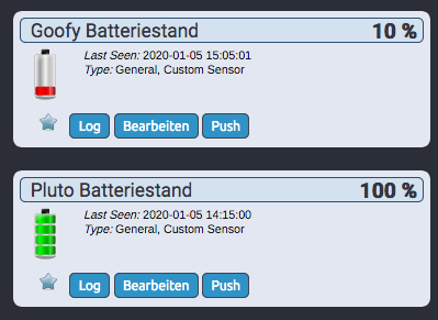

Ok... I use the icons for mixed things. One of this is a vacuum robot. See script details (if needed here): https://www.domoticz.com/forum/viewtopi ... 47#p232887
Here's the piece of code for set different icons:
If there's a question - just ask.

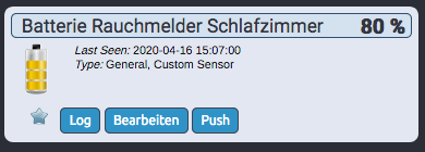

If i don't forget something..... Here it is:
Generate a new Lua-Script, device triggered (So the icon should change immediately.
Please change the variables - try out and report.

elseif BatteryLevel > 20 and BatteryLevel <= 50 then
battery_icon = Icon_Nr_ORANGE
elseif BatteryLevel > 50 and BatteryLevel <= 80 then
battery_icon = Icon_Nr_YELLOW
elseif BatteryLevel > 80 and BatteryLevel <= 100 then
battery_icon = Icon_Nr_GREEN
-- Update the icon if not the correct one is active:
if battery_icon ~= Icon then
os.execute('curl "http://localhost:'..Domoticz_Port..'/json.htm?type=setused&idx='..otherdevices_idx[Device]..'&name='..encodeURI(Device)..'&description=&switchtype=0&customimage='..battery_icon..'&devoptions=1;%25&used=true"')
print('Icon of the device '..Device..' was updated.')
return commandArray

-- Script to change the icon of a battery device depending it's level
-- Set your devices and variabels here:
Device = 'Roza baterka' -- Name of the Sensor-Device
Icon_Nr_RED = '114' -- RED = empty
Icon_Nr_ORANGE = '116' -- ORANGE = low
Icon_Nr_YELLOW = '117' -- YELLOW = ok
Icon_Nr_GREEN = '115' -- GREEN = full
-- Your Domoticz Port in URL (default: 8080)
Domoticz_Port = '8084'
-- Load the domoticz LUA library (Change the path only; default at raspberry is /home/pi/domoticz/scripts/lua/JSON.lua)
json = (loadfile "/home/pi/domoticz/scripts/lua/JSON.lua")()
-- Nothing to do after this line... :-)
-- Function we need:
function encodeURI(str)
if (str) then
str = string.gsub (str, "\n", "\r\n")
str = string.gsub (str, "([^%w ])",
function (c) return string.format ("%%%02X", string.byte(c)) end)
str = string.gsub (str, " ", "+")
return str
BatteryLevel = tonumber(otherdevices_svalues[Device])
if devicechanged[Device] then
-- Look for the icon which is used in the moment:
json_collect = assert(io.popen('curl "http://127.0.0.1:'..Domoticz_Port..'/json.htm?type=devices&rid='..otherdevices_idx[Device]..'"'))
json_collect_data = json_collect:read('*all')
json_collect:close()
Icon_Number = json:decode(json_collect_data).result[1]["CustomImage"]
Icon = tostring(Icon_Number)
-- Choose the correct icon
if BatteryLevel <= 20 then
battery_icon = Icon_Nr_RED
os.execute('curl "http://127.0.0.1:'..Domoticz_Port..'/json.htm?type=setused&idx='..otherdevices_idx[Device]..'&name='..encodeURI(Device)..'&description=&switchtype=0&customimage='..battery_icon..'&devoptions=1;%25&used=true"')
print('Correct number of icon is '..battery_icon..'')
return commandArray
